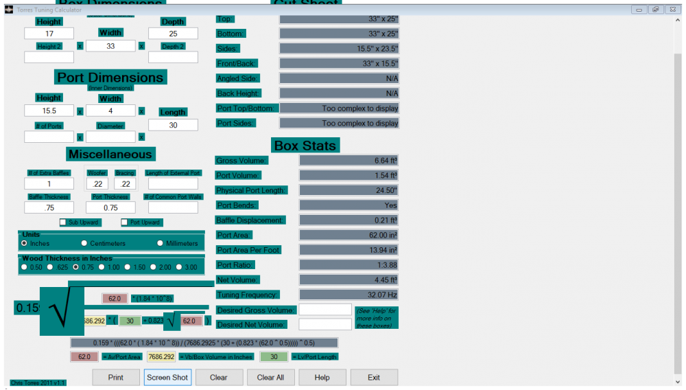

sTp Posted January 21, 2018 Report Posted January 21, 2018 Torres box calculator i punched in some number quickly with the space you have i personally think you need more space to make the box bigger here are my results. https://imgur.com/a/tlaAm Is there anyway you can make the box bigger?
gonzalez210 Posted January 21, 2018 Author Report Posted January 21, 2018 Ok i downloaded it and started playing with the numbers myself and this is what i came up with.. in the pic.. how does this look? I was able to play with a couple more inches so i did.

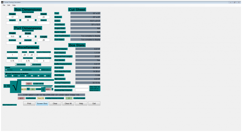

sTp Posted January 21, 2018 Report Posted January 21, 2018 I personally would make the port 4.5 just so you have a little bit more port area other than that it looks good. I am no enclosure pro but have built a few working with the measurements based on the subs recommended sizes and used Torres to work out my measurements and they have all turned out well maybe one of the more experienced people could give this a look over just to make sure everything is good.
reedal Posted January 21, 2018 Report Posted January 21, 2018 for "# of Common Port Walls" enter 3, since you said it will be a slot port along the side of the enclosure. That will add a little more to net volume and adjust tuning some. SMD Tool Map https://www.stevemeadedesigns.com/board/topic/193176-smd-tool-map-new-november-2014/ Build log https://www.stevemeadedesigns.com/board/topic/197217-reeds-03-tahoe-hat-sqaq-singer-xs-shca-cockbox-80prs/?page=32
gonzalez210 Posted January 21, 2018 Author Report Posted January 21, 2018 ok i think i finally got it, what yall think? sTp - After messing with the tuning some more i realized i have to keep the port width at 4" to keep the box at the current size; I'm starting to worry about trunk space (you know kids..) so ill sacrifice that half inch and see what happens.
