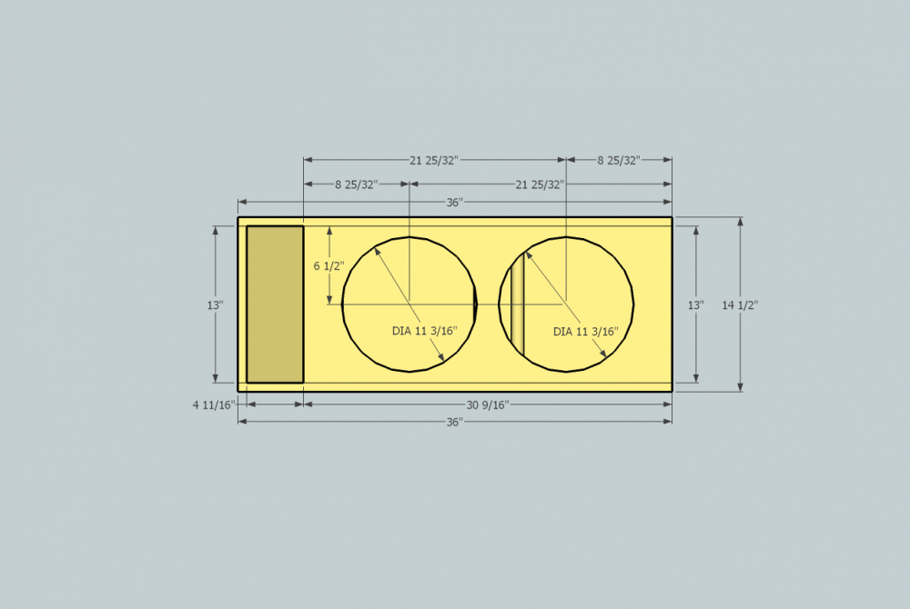

DiBo Posted January 30, 2018 Report Posted January 30, 2018 Have a pair of Sundown sa12's v3 4 ohm woofers I'm trying to design a box for. Nothing special. Going into a 2004 Nissan Maxima and my dimensions are 36x15x2? Whatever it takes to get 4 cubes or so after displacement. Tuned to 35 hz. Been running 1 sub on a kicker 1200.1 cx... Just got a pair of Orion Xtr last week. 2500.1dz and 1000.4. Can't wait to hear these paired up in a nice box. Thanks

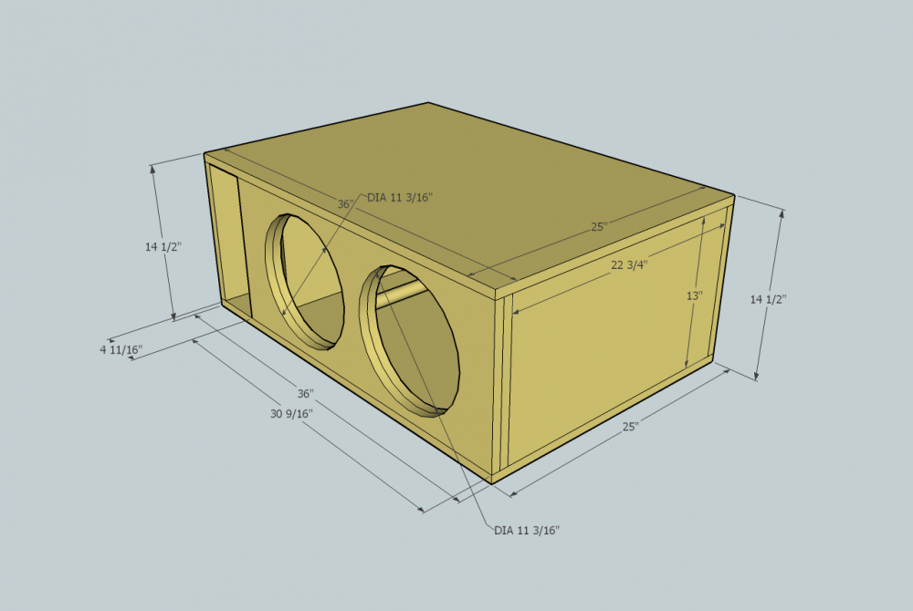

DiBo Posted January 30, 2018 Author Report Posted January 30, 2018 Found that online. Anyone see a problem with this box? Thanks

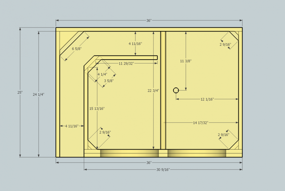

DiBo Posted January 30, 2018 Author Report Posted January 30, 2018 Can anyone give me the cubes and tuning of this before I build it?
Joe X Posted January 30, 2018 Report Posted January 30, 2018 It will be about 4.2 net tuned to 29Hz or so, about 61 square inches of port area, that's tuned pretty low it seems and looks a bit hard to build, if you don't mind any of that go ahead and build it.
DiBo Posted January 30, 2018 Author Report Posted January 30, 2018 I'm a Carpenter. I need it tuned to around 35
DiBo Posted January 30, 2018 Author Report Posted January 30, 2018 Can anyone suggest anything? Moving the port?
