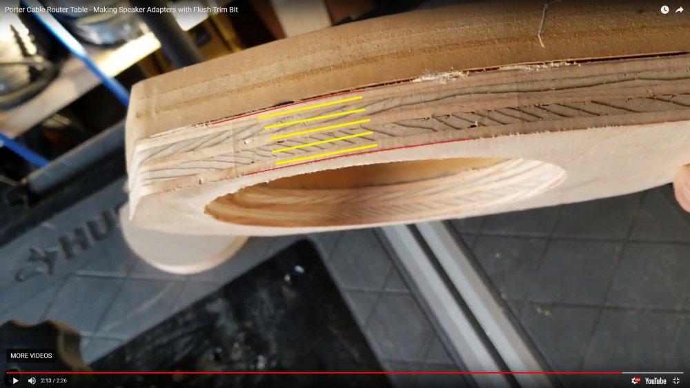

The wood is not real birch and its junk, a waste of money paying a premium price tag for nothing that is no better than basic plywood for half the cost, because that is what it is, plywood with a birch veneer.
The yellow lines are cheap plywood, the the thin layer outside the red lines are birch that is doing nothing but look pretty...

" The wood is not real birch and its junk, a waste of money paying a premium price tag for nothing that is no better than basic plywood for half the cost, because that is what it is, plywood with a birch veneer. "

Your not typically going to find a true pure 13ply baltic birch wood at a big box store and will have to go to an actual lumber yard and possibly special order it, typically a 4by8 sheet is around $80 and a 5by5 sheet is around $60.
That stuff that they sell at big box stores that claims to be maple, birch, cherry, etc is all the same cheap plywood for $20 with a thin veneer top/bottom layer. If you carpeting or painting said wood and staining it to show off the wood grain there is no real point to spend the additional money on it.
People says its lighter weight than mdf, but thats only because its plywood usually made out of a softer wood such as Doglas Fir, softer woods are lighter in weight. Where as Baltic Birch is a hard wood and very dense and heavy, per 4by8 sheet its only a couple pounds lighter than mdf.
