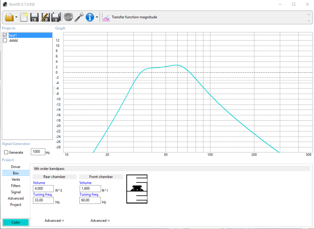

SanDiegoSlapper Posted February 23, 2018 Author Report Posted February 23, 2018 yea its really starting to seem that way. anything above 45 hz is just a buzzing noise with this box. after a long all nighter of lots of reading and research, decided to go with a 6th order bandpass. somewhere in the 33hz range for low side and 60hz on high side. not sure if i did my math right if someone is able to double check me, but it looks like 4cft-33hz low side and 1.6cft-60hz high side is working in winsd with semi flat response. For some reason the perimeters for the ZVX15 were acting a lil funky in win isd. not sure if thats normal, but some of the value didnt auto-calculate correctly. i just backspaced all the incorrectly auto-calculated values and manually put in everything from the website tho. if anyone is willing to give some help on a design or tuning, it would be GREATLY appreciated and ur help will not go to waste. this will actually be built within the next few days, unlike 90% of the people on here asking for box designs just to never even do them.

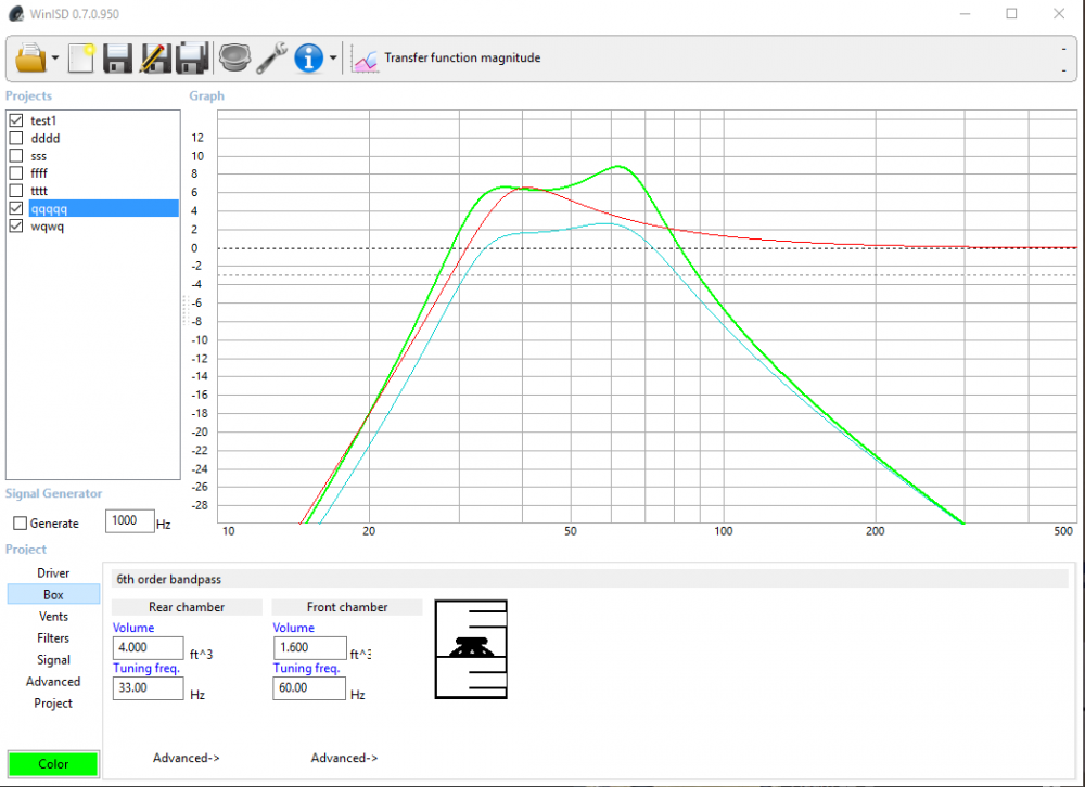

SanDiegoSlapper Posted February 23, 2018 Author Report Posted February 23, 2018 starting to wonder if the perimeters and values given on the skar audio site are incorrect for the ZVX-v2 15". idk tho, still new with WINisd, just find it very weird that every other sub i put in i can get to the 6+db range, but with the ZVX values i cant get above 2.25db unless i put like 5+cft of box space on BOTH sides of the sub. u can see here the red and green are a Skar EVL 15, but the blue is the ZVX 15. am i only looking for the "curve" here or should i be getting that bitch up in to the 6+ db's? like i mentioned earlier, when putting in the values listed on the website, winisd will INCORRECTLY auto-predict cross checking values. but with every other sub i put in, it will correctly cross check for me.
ckeeler11 Posted March 1, 2018 Report Posted March 1, 2018 Skar has been known lie about T/S parameters. I would suspect the box is the biggest issue. A ported box acts sealed an octave above tuning unless the box has leaks or is poorly deisgned. I think going to a 4th would just make more issues as they are harder to tune and get right.
