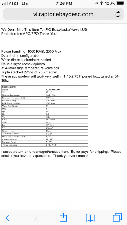

I have a EXM Audio12 that will be powered by a Sundown Sae-1500. It’s going in my 1980 firebird and max demensions are 14” height, 14” depth and 25” width

It's going to be impossible to get the correct port area and box volume even with 28" width.

The best I can do is 14.5” height, 16” depth and 30” width.
You could do a box 14.5" H x 30" W x 15.5" D with a port 13x2.5"  that is 24" long. this will give you an enclosure of 2.25 cu ft. tuned to 36 Hz. That accounts for woofer displacement and a little bracing.

Ok thanks a lot..should I do a double baffle or just put some wooden dowels on the inside?
I would do both. If you do double baffle then I would make the depth 16" so as to no eat up to much volume.
