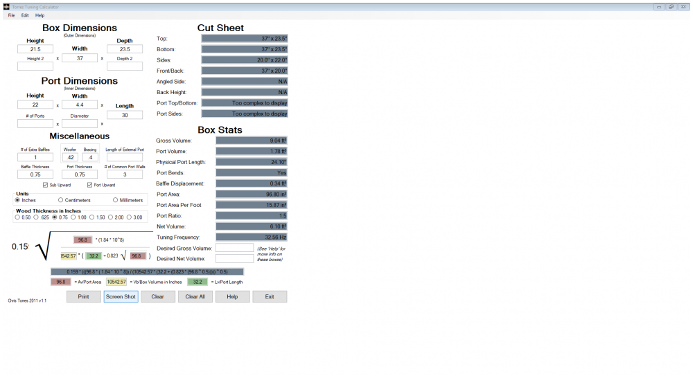

Hi guys im new here wasn't sure how or who to ask this too. I just wanted to ask if anyone can help me with a box design for my 2 dc xl 15s i will be running them off a crescendo 5500 at1ohm the subs are dual 1s or i can strap 2 5500s at half ohm but my main question is my max dimensions are (37w x 21.5 high x 23.5 deep) iv made a few designs using Torres but i wanted someone who can confidently give me something and a cut sheet if possible. I know the measurements are not that big but i even modified the rear seat latch so the rear seats stay more forward to give me more depth. My car is a Toyota Corolla 2012 hatchback.
Im actually downsizing from a no back seat car to this so that i can have rear seats and some bass close to what i did have with my 2 team fi 15s and 2 crescendo 5500 strapped at 1ohm.
Thanks in advance.
5abdb53304d96_latestscutsheet215ssmddesign.thumb.png.8335ed9c528d2722ffdc07966e7087c7.png
This is what iv been trying to figure out but i wanted it to be around 31hz but between 12-16 like 14 so i thought more musical but cant get it for some reason it goes over 16.
What i wanted to know what iv designed is that like this from looking at torres have i chosen it right? as in 3 port walls subs up port up slot port design.
