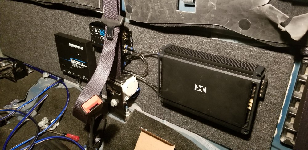

dyablo409 Posted April 3, 2018 Report Posted April 3, 2018 I have an audiocontrol lc2 to tap into the factory radio. I had already bought the audio control epicenter plus for the same reason because I was going to only do a sub stage but ended up changing the door and dash speakers and added the nvx jad800.4. Im running a pair of Rockford fosgate pps4-8" midbass and a pair of nvx nsp3.5 in the dash active. I ordered a skar sk2500v2 and 4 dc audio m3 8" at 2 ohm to wire at 1 ohm. I'm going to order 2 batteries for under the hood since I already have a spot for a second battery. For power wire I ran a 1/0 from front battery to a dist block and a 2/0 ground straight to the battery to a dist block as well. All welding wire. I will be adding another run of 1/0 power for the skar amp.

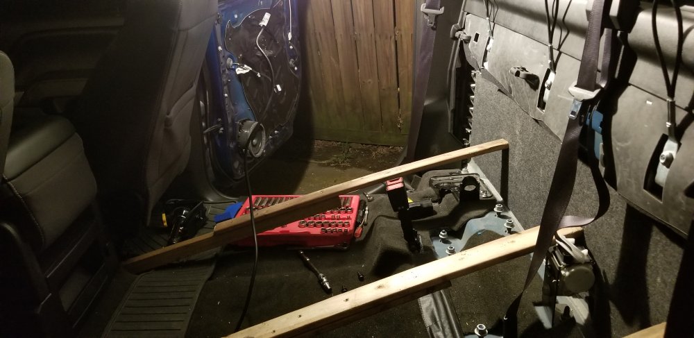

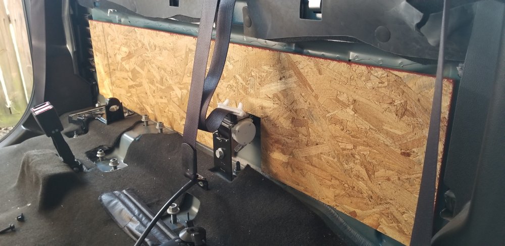

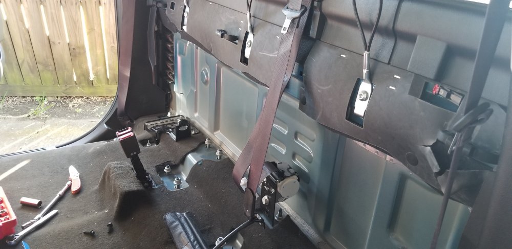

dyablo409 Posted April 3, 2018 Author Report Posted April 3, 2018 this is what i started out with i added plywood to screw all the amps and instruments .

dyablo409 Posted April 3, 2018 Author Report Posted April 3, 2018 i carpeted it and glued it to the back wall held it all night with the 1x2 putting pressure.

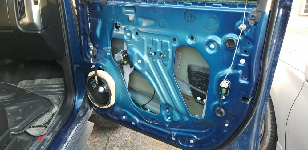

dyablo409 Posted April 3, 2018 Author Report Posted April 3, 2018 laugh at the shitty attempt of a speaker ring its my first time trying to do this. i was on limited time and only had a jig saw. when ever i make it back home to put in the subs i'll redo them properly. i dont have pictures of the deadening i put. i used second skin in the inside wall of the door and covered the big holes by tracing the oem shield on top of the luxury liner pro. i did not do the same to the back doors i left them alone. there is a night and day difference after i put the second skin in sounds way more punchier and louder.
