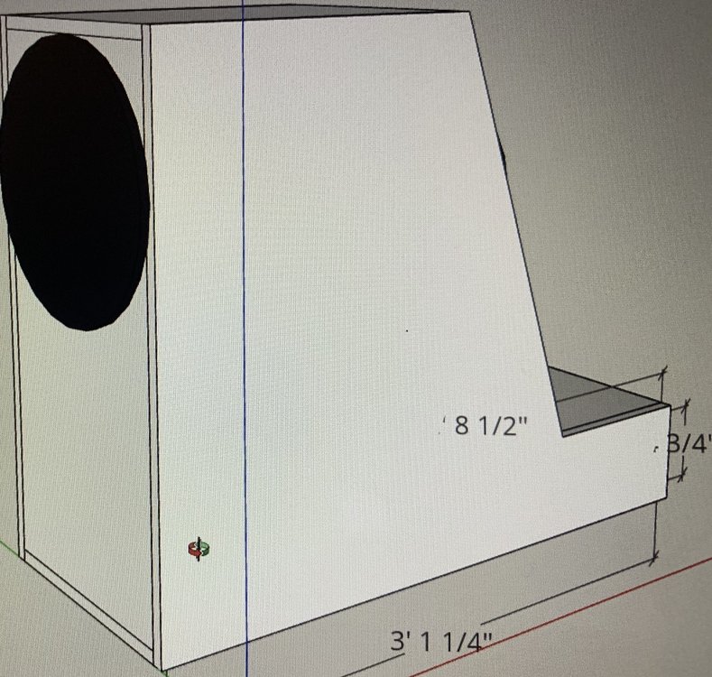

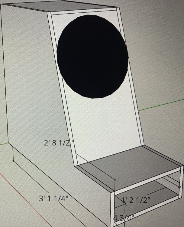

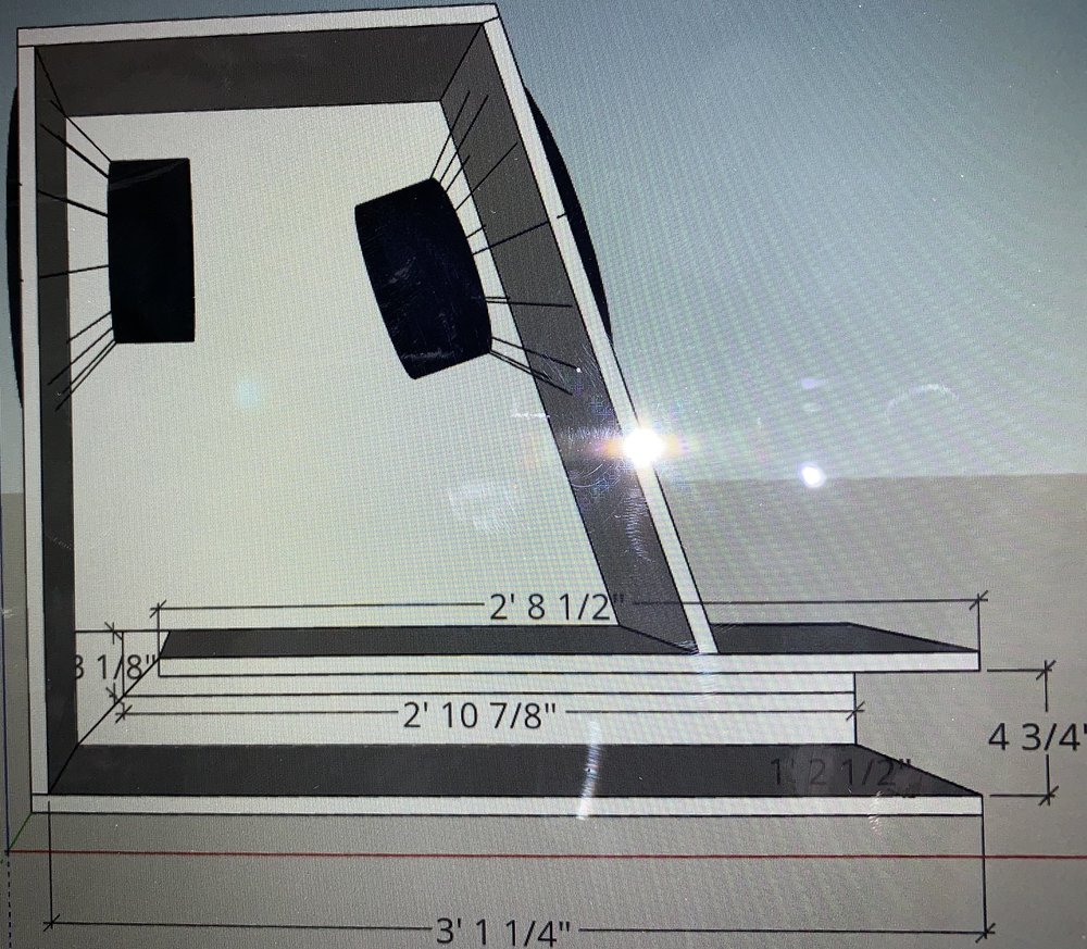

06RTCharger Posted May 29, 2019 Author Report Posted May 29, 2019 So this is the design i came up with by drawing on a paper then using the free Sketchup app.

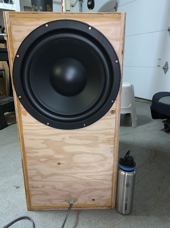

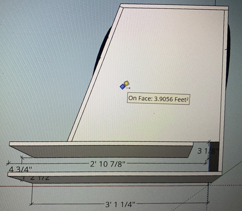

06RTCharger Posted May 29, 2019 Author Report Posted May 29, 2019 The sketchup came to life finally! Not even close to perfectly built lol but not bad for my first time building a box or wiring subs. If you wanna see the beginning to end of this PRACTICE box, heres the link to my nooby box build.

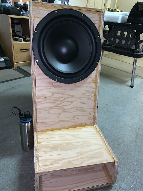

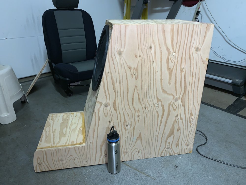

06RTCharger Posted May 29, 2019 Author Report Posted May 29, 2019 Lil profile view of this beastly middle console box lol. Thats my 24oz flask next to it.

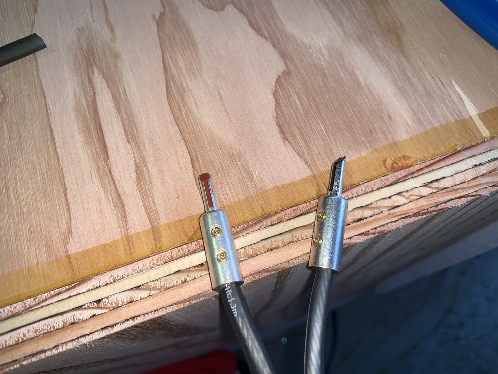

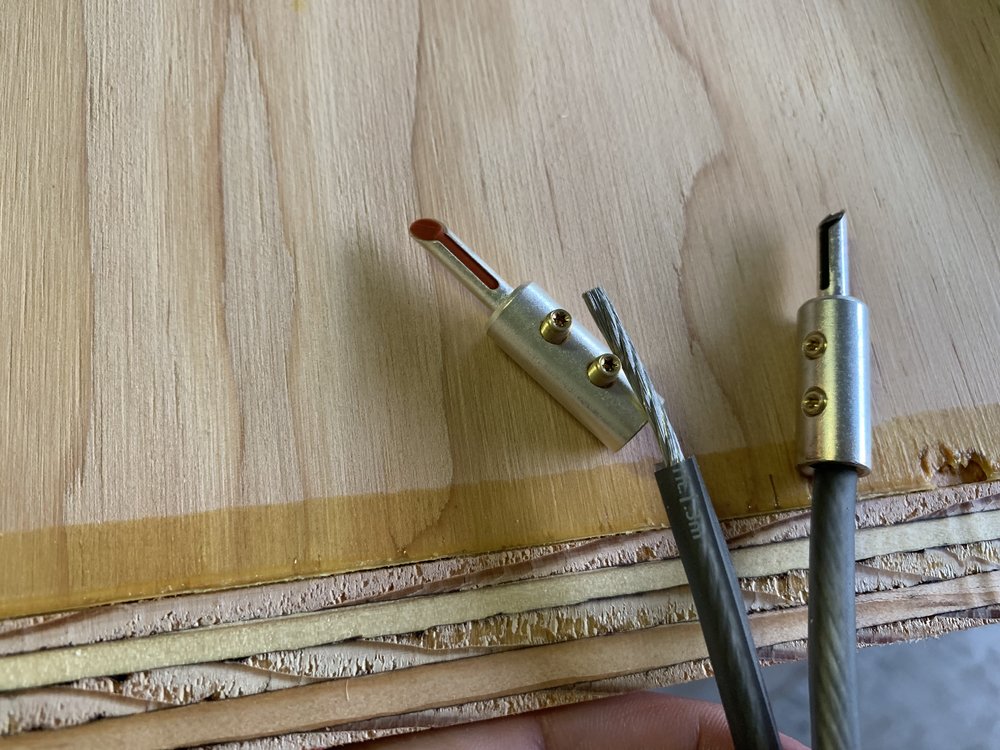

06RTCharger Posted May 29, 2019 Author Report Posted May 29, 2019 Got to use my Furez silver(AU) plated copper banana plugs. These type of terminals were suggested to me by Ray of LP. He just said banana style plugs so i found the best i could get.

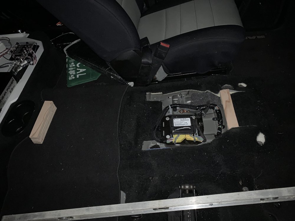

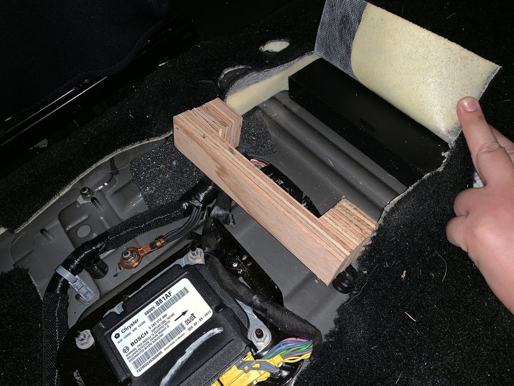

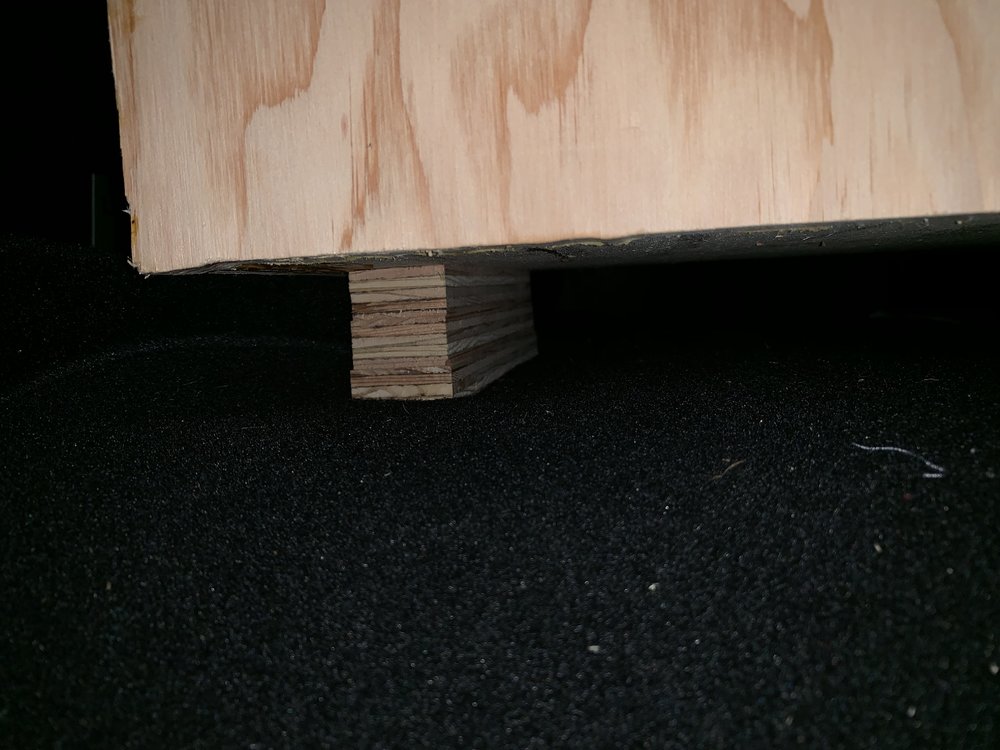

06RTCharger Posted May 29, 2019 Author Report Posted May 29, 2019 Had to make some feet for the box to lift it above some electrical wiring and modules for the truck. This ones like a bridge to leave some space for the AC vent to still blow toward the back a lil bit.

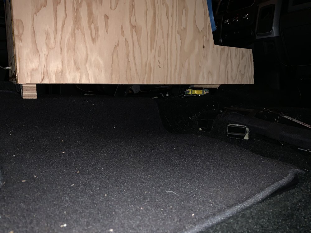

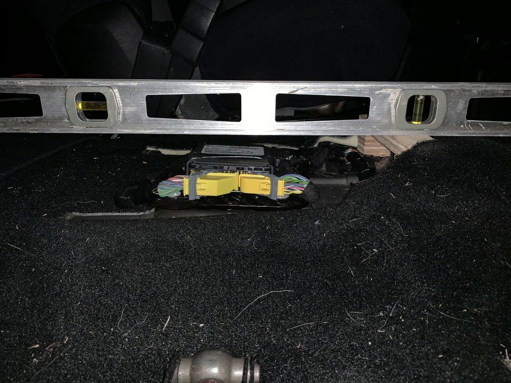

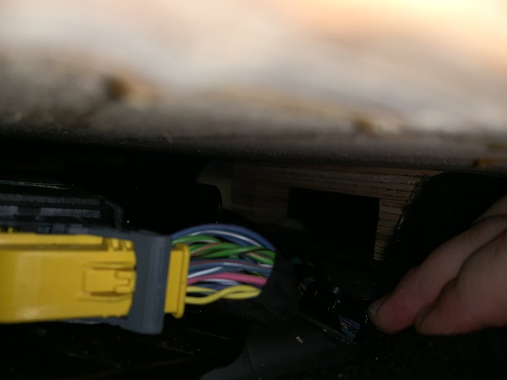

06RTCharger Posted May 29, 2019 Author Report Posted May 29, 2019 Checking the clearance with a Level.
06RTCharger Posted May 29, 2019 Author Report Posted May 29, 2019 Box is in and it clears. Pic above you can see that bridge foot thing i made.

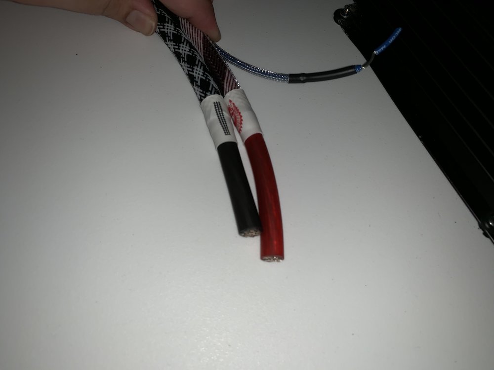

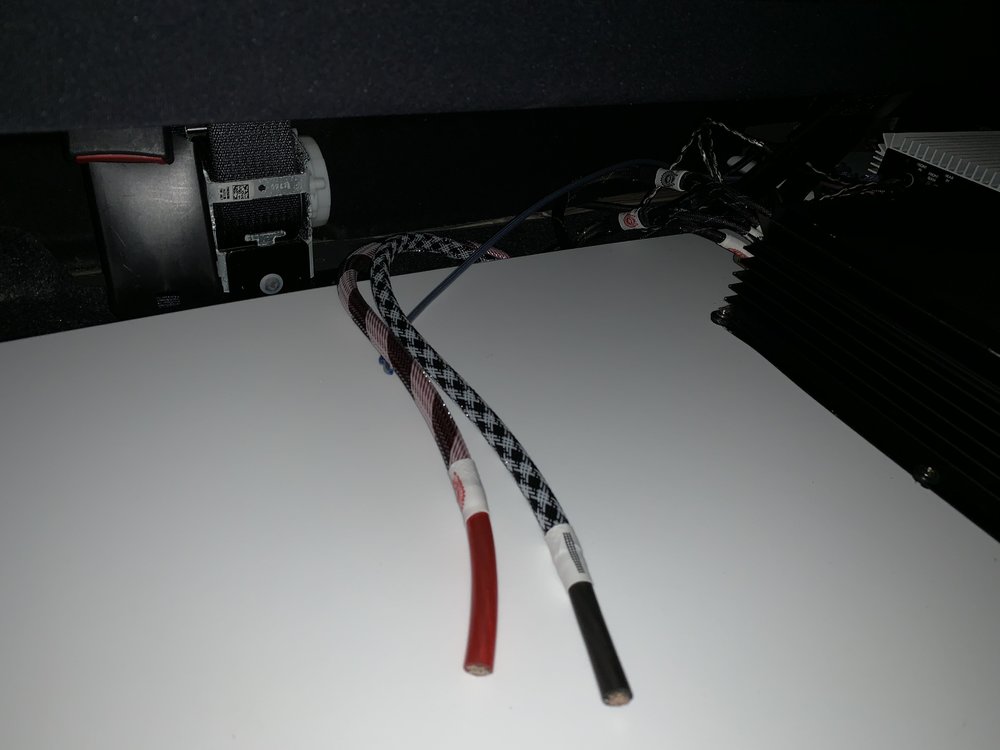

06RTCharger Posted May 29, 2019 Author Report Posted May 29, 2019 Measured out my wire runs, cut to length and then dressed them up all nice with my custom heatshrinks and techflex to match all the other amps wiring. Connected the dressed up wires to the ground/power/remote distribution blocks and ran them thru their path for the amps location. Power ground and remote wires waiting for the amp.

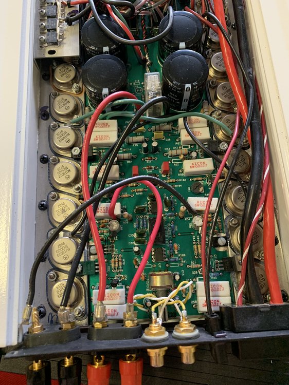

06RTCharger Posted May 29, 2019 Author Report Posted May 29, 2019 Linear Power 4.1HVS old school beast amp. Moved the taps from 8ohm to the 4ohm taps. My final load should be 4ohm becuase im using Two DVC 4ohm subs. I had to swap out the negative speaker terminals (5-way binding posts) because if you look close you can see that the holes are alot smaller than the positive terminals holes. But as i post this.....i just realized i didnt have to swap it because im using banana plugs, which wont be using that specific holes lol oh well.
