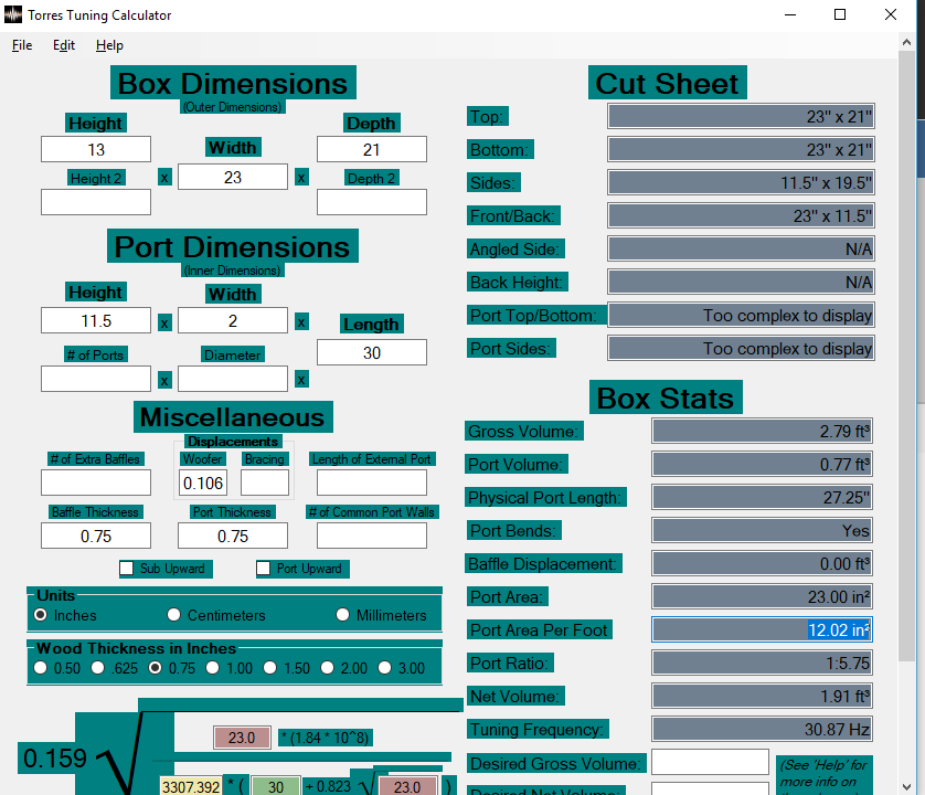

  I'm getting ready to head to Depot for some wood and I was wondering if someone could review my current box specs to see if this would be okay for this setup. I'm looking to play around 30hz on  approx
+/- 1200wrms. The subwoofer is a Fosgate Pwr T1 Dual 2 12". Any help is greatly appreciated!!

I apologize for all of the copies, below is my current box specs.

Just judging by your dimensions, your port is probably a "3 common wall" port.   You will want to enter "3" into the field for "# of Common Port Walls".  It will lower your tuning.  You will probably still come out tuned a bit lower than what Torres says.

Sorry for asking, but software are you using for making the calculation?
Thanks
Torres Box tuning calculator
