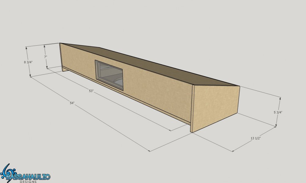

Dragonware Posted May 31, 2018 Report Posted May 31, 2018 This is what someone came up with for me anyone want to change my mind ? 2018 ford F150 XLT super crew. 3 x Sundown Audio SD3-10s 500RMS each on a Hifonics BRX2000.1D Down Fire. My Build log : http://www.stevemeadedesigns.com/board/topic/170934-dragonmobile-re-audio-2300rms-stealth-build-08-focus/ Current System 2020 Ford F-150 XLT Supercrew Audio Control Epicenter Audio Control LC7i Taramp PRO 2.6 DSP Taramp DS4x800 - Highs Taramp HD3000.1 Mids Taramp MD5000.1 Bass 8 x DS18 6.5 Pro x6m - mids 2 x Soundsteam SST-05 Bullet Tweeter 2 x DS18 TW220 Super Tweeters 4 X SkarAudio EVL-8 BASS Big 3 Yellow Top
Crazy 8s Drums Posted May 31, 2018 Report Posted May 31, 2018 Why do you lack the confidence in this design? Orion XTR amplifiers Skar subs
Dragonware Posted May 31, 2018 Author Report Posted May 31, 2018 No i dont lack confidence in this design just thinking they are more ways to skin a cat so im sure they might be other configurations and ways to do this My Build log : http://www.stevemeadedesigns.com/board/topic/170934-dragonmobile-re-audio-2300rms-stealth-build-08-focus/ Current System 2020 Ford F-150 XLT Supercrew Audio Control Epicenter Audio Control LC7i Taramp PRO 2.6 DSP Taramp DS4x800 - Highs Taramp HD3000.1 Mids Taramp MD5000.1 Bass 8 x DS18 6.5 Pro x6m - mids 2 x Soundsteam SST-05 Bullet Tweeter 2 x DS18 TW220 Super Tweeters 4 X SkarAudio EVL-8 BASS Big 3 Yellow Top
Crazy 8s Drums Posted May 31, 2018 Report Posted May 31, 2018 There is not much room underneath it for it to breathe, and it will act more like a ported box that doesn't have enough internal volume to be most efficient. This is not my area of expertise and others may offer a different reply, but you might consider using two 10"s and make it a real ported box. My .02 I know that you dont have much space to work with in a f150... ? If you don't mind getting rid of the little seats in back, you could put all kinds of stuff in there. Orion XTR amplifiers Skar subs
Dragonware Posted May 31, 2018 Author Report Posted May 31, 2018 2 minutes ago, Crazy 8s Drums said: There is not much room underneath it for it to breathe, and it will act more like a ported box that doesn't have enough internal volume to be most efficient. This is not my area of expertise and others may offer a different reply, but you might consider using two 10"s and make it a real ported box. My .02 I know that you dont have much space to work with in a f150... If you don't mind getting rid of the little seats in back, you could put all kinds of stuff in there. They arnt little seats its a supercrew full sized seats and lifting or removing them is not an option I got baby and mommy back there My Build log : http://www.stevemeadedesigns.com/board/topic/170934-dragonmobile-re-audio-2300rms-stealth-build-08-focus/ Current System 2020 Ford F-150 XLT Supercrew Audio Control Epicenter Audio Control LC7i Taramp PRO 2.6 DSP Taramp DS4x800 - Highs Taramp HD3000.1 Mids Taramp MD5000.1 Bass 8 x DS18 6.5 Pro x6m - mids 2 x Soundsteam SST-05 Bullet Tweeter 2 x DS18 TW220 Super Tweeters 4 X SkarAudio EVL-8 BASS Big 3 Yellow Top
ckeeler11 Posted June 4, 2018 Report Posted June 4, 2018 Lifting is an option. plenty of people do it. HAving said that the box has 1.97 cu. ft of volume so you are good htere. Also hase 1.25" clearance for subs underneath so good there. I would run it. http://www.lmiwelding.com/kits_supercab.htm
Dragonware Posted June 8, 2018 Author Report Posted June 8, 2018 On 6/4/2018 at 3:07 PM, ckeeler11 said: Lifting is an option. plenty of people do it. HAving said that the box has 1.97 cu. ft of volume so you are good htere. Also hase 1.25" clearance for subs underneath so good there. I would run it. http://www.lmiwelding.com/kits_supercab.htm I know lifting is an option it just is not an option for me there is wife and baby back there plus lots of passengers. ideally i would of like to find some way to get a 2000 RMS ported option even 1 sub that can take the over power an still perform My Build log : http://www.stevemeadedesigns.com/board/topic/170934-dragonmobile-re-audio-2300rms-stealth-build-08-focus/ Current System 2020 Ford F-150 XLT Supercrew Audio Control Epicenter Audio Control LC7i Taramp PRO 2.6 DSP Taramp DS4x800 - Highs Taramp HD3000.1 Mids Taramp MD5000.1 Bass 8 x DS18 6.5 Pro x6m - mids 2 x Soundsteam SST-05 Bullet Tweeter 2 x DS18 TW220 Super Tweeters 4 X SkarAudio EVL-8 BASS Big 3 Yellow Top
SkarredSierra Posted June 8, 2018 Report Posted June 8, 2018 Y isnt lifting an option? It doesnt eliminate any seating. Just reduces headroom a lil. If that enclosure fits use it. The three 10s sealed will sound great on 2k. Ron i think did 3 sa 10s under his rear seat.
