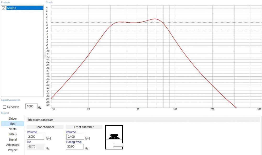

timc31610 Posted September 7, 2018 Author Report Posted September 7, 2018 Ok, so I am thinking a single Skar ZVX-8 D4 in a 4th order. I plotted it in Winisd but truthfully I have no clue what I am looking at. Could I get some input? I generally see recommendations in the 2:1 or 3:1 ratio. I assumed it was ported to sealed but Winisd has the sealed side larger. My Build Log 94 Civic http://www.stevemeadedesigns.com/board/topic/188644-94-civic-4-door-build-loq-suggestions-wanted-will-be-super-slow-mo/ Faceebook reluctantly
ckeeler11 Posted September 7, 2018 Report Posted September 7, 2018 the graph looks pretty good but once you put it in the vehicle that will change drastically. Why stuck on the 4th? I would just do a regular ported or sealed enclosure and make it down firing so you can pile shit on the box.
