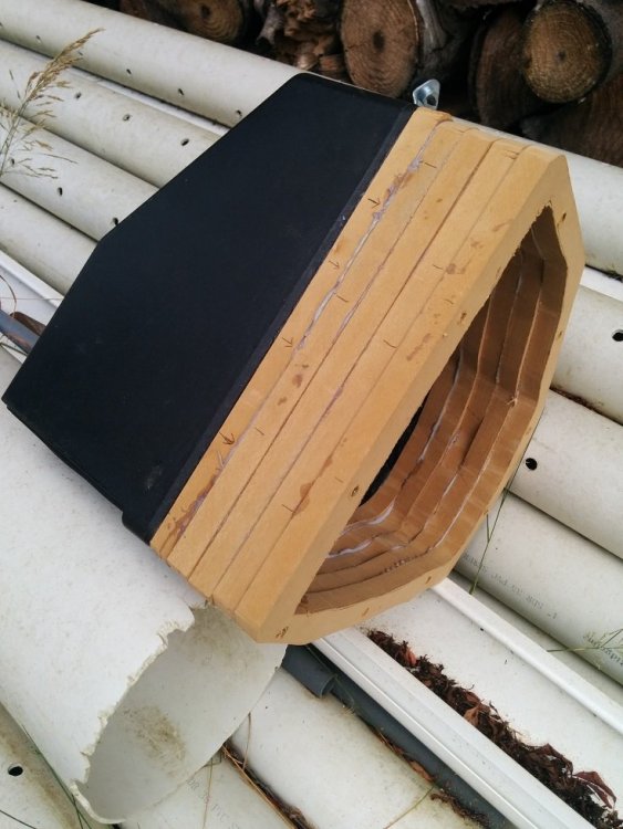

pics of new box build for Silverado
CorNut

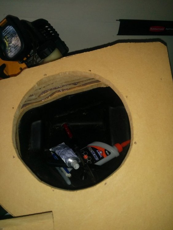

It's a single RE shallow mount 10, It was a lot of work for the amount of bass it gives me.
RE discontinued their shallow subs but I had one sitting around. The box came to 1.07 cu ft before displacement/tuning. Figuring out the volume with the curves was difficult so I lined the box with a shower curtain & filled it to see how many gallons/cups of water it held. In the end, it finished .87 @ 35hz. The sub's recommended vented size is .65-1.0, it sounds fine for what it is, but I'd like more. I went with a 3" round port, it's the largest round port I could fit, placement isn't ideal. With the box changing shape in so many places, a slot port would've been difficult.

I'm guessing I'll replace it at some point. Due to the angle, the box has a 3.5" mounting depth so a SD3 wouldn't fit. I built the box low enough that an adult can sit in the back and it won't sag into the box. The areas on top where I increased volume/depth slightly can be cut out/added to at the expense of rear passengers' comfort. The box is far enough (~2") from the floor to surface mount a driver to install a 12 if I can increase the volume enough to support it. I haven't messed with the MS-8's tuning since installing the RE but I don't expect that to help much.
I thought about raising my seat so I wouldn't be as limited in sub selection but I found the RE Audio SL-10 D4,16mm xmax and it reviewed well so I went with it. I've always done small package installs but this is my first true shallow mount sub. Good luck with your build, I haven't heard an F8L but my car has a single Sundown SA-8 v.2 which is similar, it amazes people when they see it's a single 8" in a small, modified (sub rings+external port) factory enclosure.
