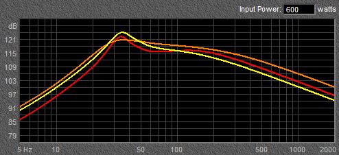

Modeling comparison:
Red) 2xE-8 1.5@35Hz
Orange) 1xE-12 1.75@35Hz
Yellow) 1xSA-12
From this it can be seen:
1) the single E-12 will produce the flattest response, will be the cheapest option and will have the least power handling, best option for a non loud musical setup.
2) the dual E-8s will produce a very peaky output being very weak away from tuning.
3) the single SA-12 will produce overall best output while not being as peaky as the E-8s and will handle 1K power or more if needed, with output in mind this is the best option, cost comparable to the E-8s.
