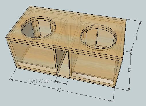

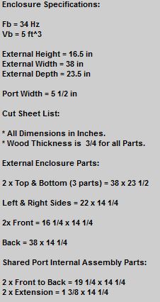

Joe X Posted September 24, 2018 Report Posted September 24, 2018 So here is a suggestion, power: to subs rated, amp subsonic filter to 28Hz, minimum port clearance 5 1/2", figure is just an assembly guide:

Thursty2018 Posted September 29, 2018 Author Report Posted September 29, 2018 Box came together good after having to either trim peices down or cut new ones all together from lumber yard cutting them wrong. Next time i will just cut them myself. Im a little confused on box volume though i come up with 6.97 gross volume is it supposed to be 5 cubes net? Am i missing something i took displacement of subs and any braces but still not close to 5 cubes and port seems really close to back wall of box about 2 inches or so is that ok ? Any help would be great thanks.
mestapho Posted September 29, 2018 Report Posted September 29, 2018 You didn't calculate w/consideration of the double top baffle. Gross volume is 6.621 ft3 Port volume is 1 ft cubed subs displace .18 That leave 5.5 ft3, then subtract bracing. 5.0 ft3 net seems correct

Joe X Posted September 29, 2018 Report Posted September 29, 2018 If you need a custom figure let me know, this is a shared port, port area splits in two but it's still the same even if it may look odd if you are not familiar with it.
mestapho Posted September 29, 2018 Report Posted September 29, 2018 The back ports are half the width of the main port when they split when using a center port.
