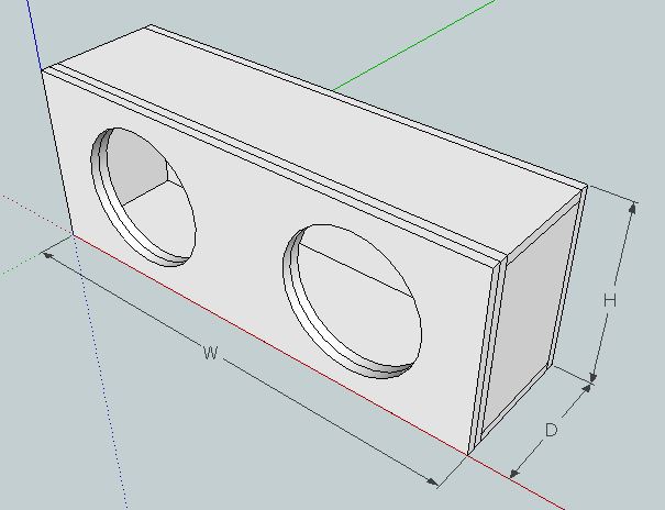

Mactools43 Posted September 28, 2018 Report Posted September 28, 2018 Need help with a cut sheet for 2 brz15d4 going in a trailblazer
Mactools43 Posted September 28, 2018 Author Report Posted September 28, 2018 New to the forums ported or sealed and a cut sheet would be great?
Joe X Posted September 28, 2018 Report Posted September 28, 2018 Post max dimensions for a box and amp you are using.
Mactools43 Posted September 29, 2018 Author Report Posted September 29, 2018 40x18x20 massive audio amp
image91 Posted September 30, 2018 Report Posted September 30, 2018 Model on amp would help Joe's input a lot. Any details you can present are always a plus for someone trying to help out ?
Joe X Posted October 1, 2018 Report Posted October 1, 2018 Many of these low cost subs hardly take rated so the advise is simply not go beyond that even if the amp can. So here is a couple of suggestios, power: to subs rated, for the ported box amp subsonic filter to 27Hz, minimum port clearance 4 1/4", figures are just an assembly guides: Sealed Box, these subs are mainly designed for sealed: Ported is louder as always but these subs will not perform on the bottom end as well as some of the more expensive counterparts, the box is made to try to bring up the low end as possible:
