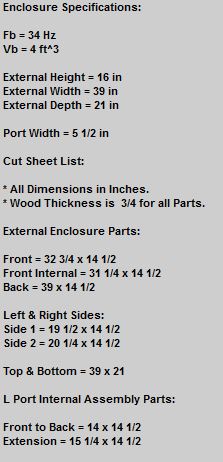

Joe X Posted October 3, 2018 Report Posted October 3, 2018 So here is a suggestion, daily loud aimed, power: to subs rated, amp subsonic filter to 28Hz, minimum port clearance 5 1/2", figure is just an assembly guide: NOTE: If building outside you need to build a cardboard dummy box to test fit in it's way inside.

tcast305 Posted October 3, 2018 Author Report Posted October 3, 2018 Joe X, Thanks a lot for the box design, much appreciated. Thanks.
tcast305 Posted October 3, 2018 Author Report Posted October 3, 2018 Joe X, Is it possible for you to give me the cut measurements for the 3 corner pieces for inside the enclosure? Thanks.
Joe X Posted October 4, 2018 Report Posted October 4, 2018 like this: The width of the 45 inside the port should allow a port width of 5 1/2", notice that the front to back port part has a 45 deg cut, so the 5 5/8" is only valid if you do that 45 deg cut, be aware that if the port width is less than 5 1/2" at the turn that will damage the box performance. If you would like a lower tuning, let me know, anyhow to make that possible the box depth may need to grow 1-2".
tcast305 Posted October 4, 2018 Author Report Posted October 4, 2018 Joe X, Got it, I spoke with Colin from Wolfram and he suggested that 34hz would be perfect for me. I see the 45 on the front to back port piece. Is there a 45 on the extension piece on the other end or should it be rounded or can it be left alone? Thanks.
