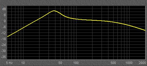

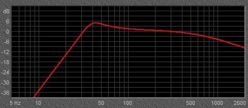

Joe X Posted October 9, 2018 Report Posted October 9, 2018 Plots below are for a 3.5 net @ 34 Hz box and the TSX 15": The first plot should be similar to what you see on WinISD, the bump you see around tuning is a result of the port action on output, your also see that you output sharply drops below tuning, this sharp drop is a result of the ported enclosure system not the driver. Inside a car and as a consequence of cabin gain you get something like this roughly: You get to play 25Hz about as loud as 50Hz, thanks to cabin gain you can listen to rap and such properly. On the calculators since WinISD is not compatible with slot ports you can just dismiss the result, Torres has it's own problems but in this case actual tuning will be closer to what Torres says.
