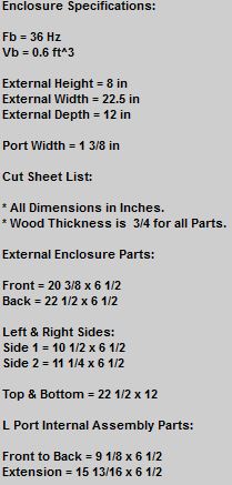

sander815 Posted October 8, 2018 Report Posted October 8, 2018 i am planning to buy one of these subs, to create a subwoofer skar audio EVL-65 6.5". Does anyone have a building plan for it, vented?
mestapho Posted October 8, 2018 Report Posted October 8, 2018 I have one for four and two .3 cubes net per sub ported recommended tuning 39 Hz
Joe X Posted October 10, 2018 Report Posted October 10, 2018 So here is a suggestion, power: to sub rated, amp subsonic filter to 35Hz, minimum port clearance 1 3/8", figure is just an assembly guide:
