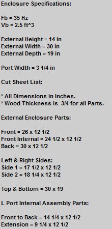

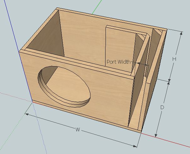

Joe X Posted October 18, 2018 Report Posted October 18, 2018 So here is a suggestion, power: to sub rated, amp subsonic filter to 28Hz, minimum port clearance 3 1/4", figure is just an assembly guide: NOTE: If building outside you need to build a cardboard dummy box to test fit in it's way inside.

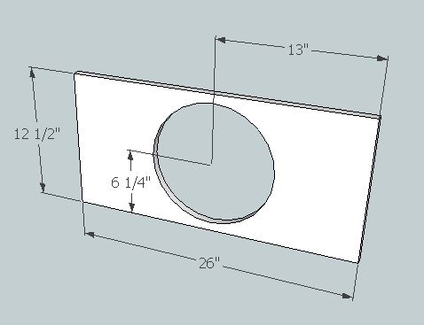

Donzi42 Posted October 19, 2018 Author Report Posted October 19, 2018 What is the position of the hole from side to side
Joe X Posted October 19, 2018 Report Posted October 19, 2018 You can place it in the center of the "Front" part:
