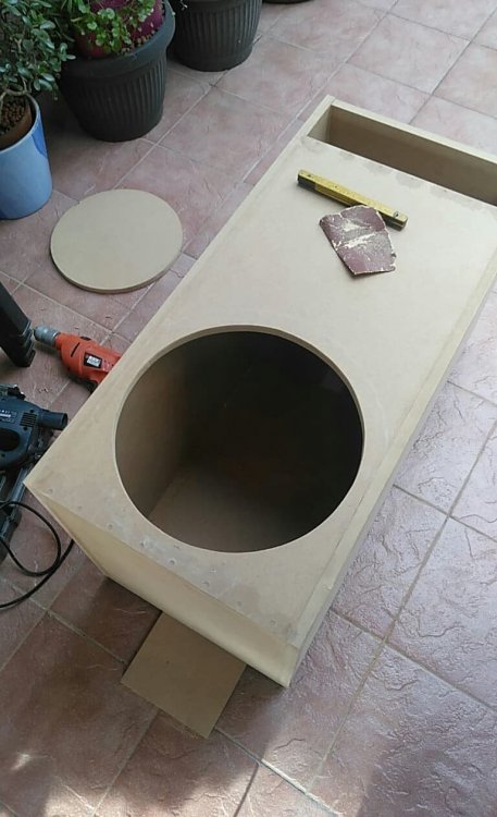

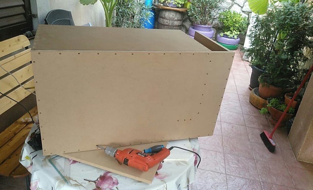

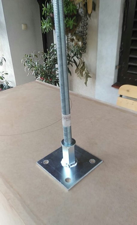

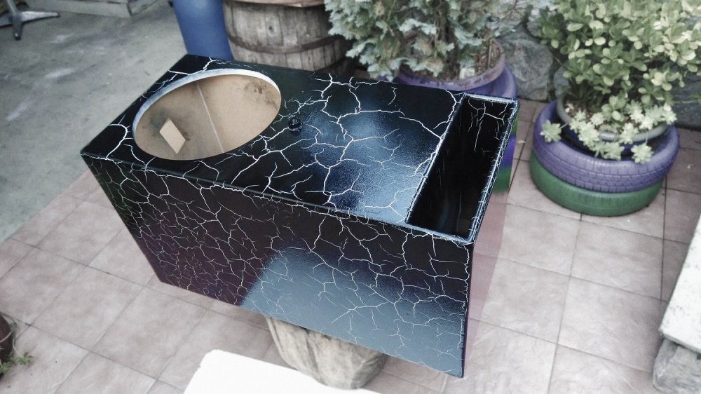

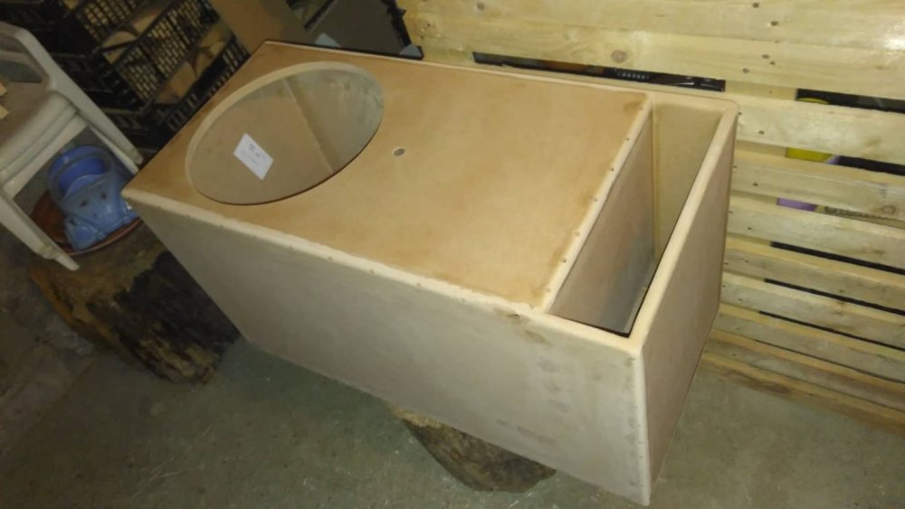

Antoni Čović Posted November 4, 2018 Author Report Posted November 4, 2018 80% Job done.. Gone with 33hz, 4.5cuft design.. threaded rod and black mat paint more to go
Antoni Čović Posted November 11, 2018 Author Report Posted November 11, 2018 Update: Tried it in car and not happy.. lost a lot of upper frequencies and it sounds unbalanced.. a lot power on lower notes and just few notes up power dissapears.. seems too big box for this sub.
