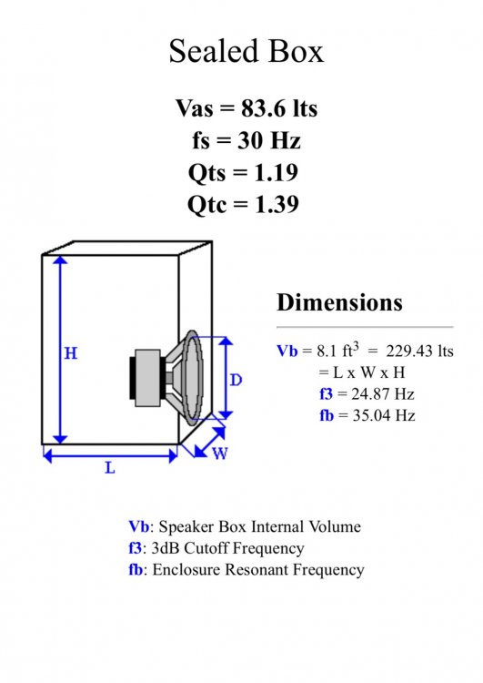

GottemGood1214 Posted November 12, 2018 Report Posted November 12, 2018 With them specs given it calculated a sealed box. This is what I found

SaLvia Posted November 14, 2018 Author Report Posted November 14, 2018 My manufacturer specs box design 45.0 liter @Joe X recommended sealed 1.0ft3 = 28.3 liter i was very hesistant I want to make the most right box when I do
Joe X Posted November 14, 2018 Report Posted November 14, 2018 The enclosure you show is about 1 cubic feet internal volume, the 45 liters or so you mention is the external volume.

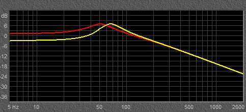

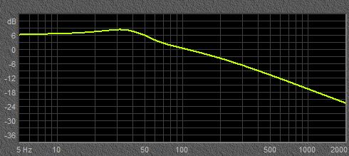

Joe X Posted November 14, 2018 Report Posted November 14, 2018 Most 12" subs will work on a 1 cubic feet net sealed enclosure, however this sub seems to be designed to work in a infinite baffle setup like if you mounted it your rear deck without an enclosure, so the trunk acts as a large enclosure, not a standard one, modelling seems to show the sub needs more space: Yellow is 1 cubic feet net sealed, red is 2 cubic feet net sealed: You see the red plot gets more lows and peaks less and at lower frequency, here's how the sub would perform in an infinite baffle setup: That looks nice to 50Hz except you need to keep 350W - or else.
