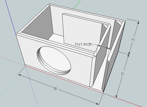

So here is a suggestion, power: to sub rated, amp subsonic filter to 28Hz, minimum port clearance 4", figure is just an assembly guide:
NOTE: If building outside you need to build a cardboard dummy box to test fit in it's way inside.
