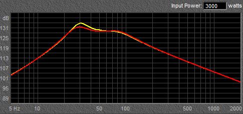

DiBo Posted November 25, 2018 Author Report Posted November 25, 2018 By model you mean plugging in box and woofer specs to see response curve rt? That's a skill I have yet to learn. Definitely on my "must learn" list. If I post enclosure specs here can you model it for me? I'll be learning this very soon. 48x20hx30d Port 17.5x7.5x30 1.5" port thickness .75 baffle thickness. Triple baffle

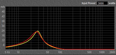

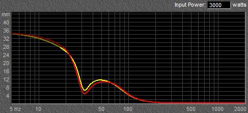

Joe X Posted November 26, 2018 Report Posted November 26, 2018 So let's try their ported recommendation (4 net) and a 6 net alternative ( yellow plot ) picked 3K per driver for power: You can see that 4 net projected performance will be near flat, the 6 net peaks more and you are getting more output for your power, the SPL guy will pick 6 net of course. Now the excursion plot, they say it's above 2 inches peak to peak assuming it's linear excursion Xmax would be say 2.2 inches p-p/2= 1.1 in or like 28mm: Again assuming they are giving linear excursion, there would be no problems even if the box was 8 net per driver. Finally here's vent airspeed, just me picking a port area to match 23-24 m/s peak airspeed: Results are 60 square inches per driver for 4 net per driver and 70 square inches per driver for the 6 net. So if the question is if you are limited to 4 net with those drivers then the answer seems no even if you are over powering some. Will work on 4 net? Yes in a flat like alignment losing about 3dB of tuning bass to the 6 net,
DiBo Posted November 26, 2018 Author Report Posted November 26, 2018 So I can go basically build this 4-6ft³ with 60-70sq in of port area. 4 nets a flatter response and 6 gives me about a 3db bass boost. 6ft³ net doesn't seem too peaky at all. I wonder why Sundown recommends 4ft³ when 5-6ft³ seems the better recommendation. I appreciate the lesson sir.
