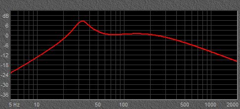

Inside a car the response will be peakier than what WinISD shows, something  closer to the plot  below, part of the reason is that you picked a larger than recommended net volume:
Other than that it looks fine as long as you use your subsonic filter and don't push too much power.

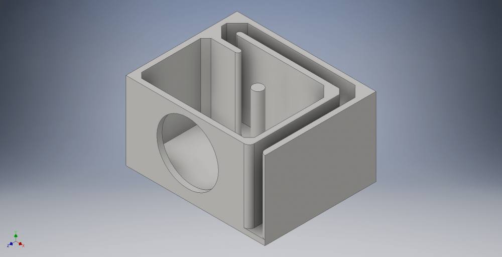

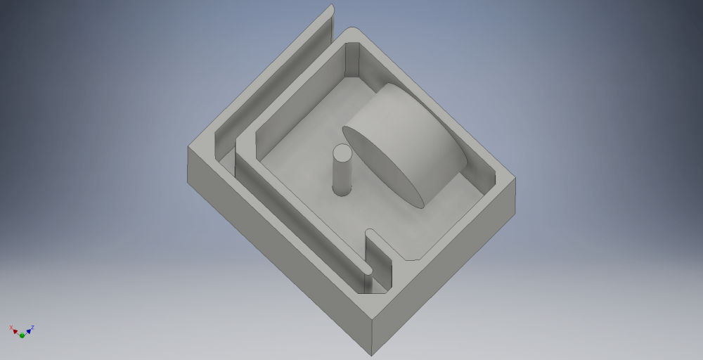

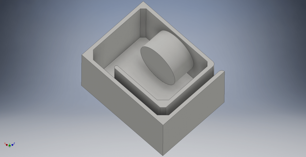

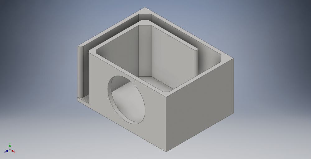

What about this one I made? Would it work better?
Box Specs:
External Height: 12"
External Width: 20"
External Depth: 16"
Frequency: 32.2 Hz
Internal Volume (excluding sub, port, ect.): 1.02ft^3
Port area: 15.75in^2 (1.5" x 10.5")
Port Center Length: 37.5"

Lots of turns in the port is not recommended, I guess it's no big deal anyways but just saying, if you want to have less turns use just the necessary port area as determined by the manufacturer, tune a little higher (1 Hz difference will not be audible) and maybe do the box a little wider.
Would it just be better to take the port area down to 13in^2 (1.25 x 10.5) instead of the recommended 16in^2?

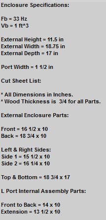

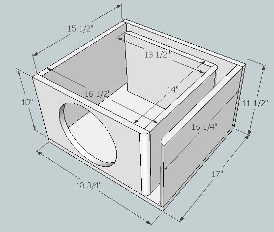

Here's a suggestion if you want to keep 1 net, it has 15 square inches of port area and a 33Hz tuning, differences should not be audible from your original spec,  the second turn is a 90 deg turn not 180 deg so it may be more efficient.
If you don't mind going above 1 net maybe your first box would be best.
