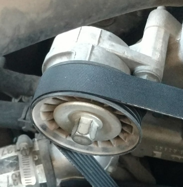

LotsofChevys Posted December 19, 2018 Author Report Posted December 19, 2018 So the 93.06" gates was still too tight. So no Goldilocks with gates. Gonna try a continental 93" which is what is called for for the 145 but is a gator back I guess. Guess they run a tad smaller.. 2360 vs 2363mm. Doesn't seem like I can find anything closer with the 2250 being way too small
LotsofChevys Posted December 20, 2018 Author Report Posted December 20, 2018 Well different brand (continental) seems to be tighter, also has a texture to the smooth side.. maybe this will be the one lol
LotsofChevys Posted December 21, 2018 Author Report Posted December 21, 2018 Nope.. I guess back to checking grounds,etc.. keep u guys posted if and when I fix it
