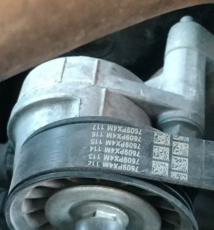

I have a 93.5" belt that was for the old 145amp alternator that I had upgraded from the factory 105amp, which called for a 92.9" belt..  i could try the original one I guess as long as I stay within the normal range on the tensioner? I guess I could call DC also to see if they spec it out for the 105 amp size which I wouldnt expect but u never know. I appreciate the help tho, the belt slipping was my first thought.

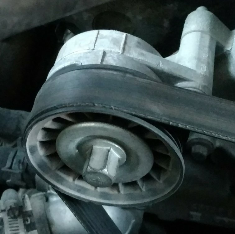

So I tried the new old belt which according to the tensioner lines was gonna be way too tight. There does seem to be a belt size between the two per the gates website which is 5mm longer than the short one I have and 13mm less than the one that is on there. Guess I can pick one up just to see what that does. The pulley on the DC is definitely smaller (1 3/10) vs the stock (1 6/10) per a caliper I had lying around. Thanks guys
So just a note, upon starting this morning the tensioner indicator was at the left line barely, (started in the middle)and it took about 2-3 min for the alternator to kick in. Gonna buy the "Goldilocks" belt size and hope for the best
