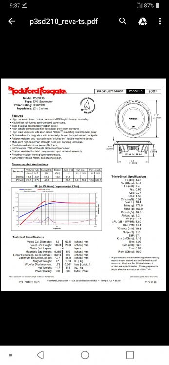

jrm088 Posted December 29, 2018 Author Report Posted December 29, 2018 im running (2) rockford p3sd210's with a 600w hifonics zrx616.4 before i make any cuts on the box i want to be 100 percent sure about aeroport placement because im still a bit confused. ive read that you want the flare inside the box to be a diameters distance from the wall of the box. if i cut the port in the side of the box (3"x9" port with 2 flares) id have 15" from the flare to the center of box, would'nt that be to much space? if i cut the port in the top of the box id be left with 12"from the inside flare to the bottom wall. i hope im understanding this all correctly. if this is the case and is not optimal to have that much of a gap from the flare to the box then i could cut the port in the front of the box next to the sub and use an elbow to get the placement and proper distance from the inside wall. any suggestions or input, im a noob to box building.
slowfkncar Posted December 29, 2018 Report Posted December 29, 2018 You are pretty close to the recommended enclosure & power, i dont think its a concern with having the inner aero port far away from any walls ect, just as long as its not obstructed. If it were me, id port them on the side down low. http://rftech.custhelp.com/app/answers/detail/a_id/1051
