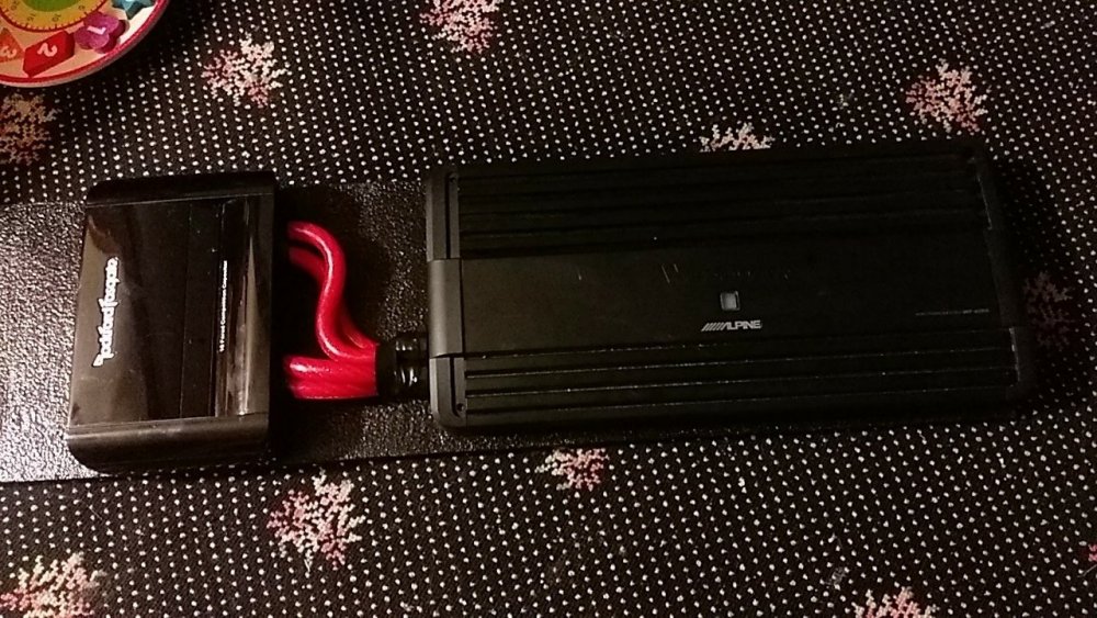

So I've seen this done alot of times and my current build is going to be wired this way because I think it looks badass and I have the equipment to do it but I'm just wondering is there any gain in amps by doubling your wires to your amplifier I have a alpine MRP-M2000 with a single 0awg terminal but wired with customer machined dual 0awg splitters.
No gain in amperage nope. A wire does have some resistance over its length, but it's negligible (especially at that short of length). What you're doing will be for aesthetics only.
A wire only needs to be a certain thickness depending on how much current you need to flow through it and how long it is. See this chart: The-Formula-on-How-to-Find-What-Gauge-Wi
Ok nice to know thank you and I saved that chart helpful tool. And I'm going to leave the dual setup because fuck it, I have the parts and it looks badass! But thank you again.

I like the looks of it myself.  Id use machined dual inputs instead of the tape but still looks good.
