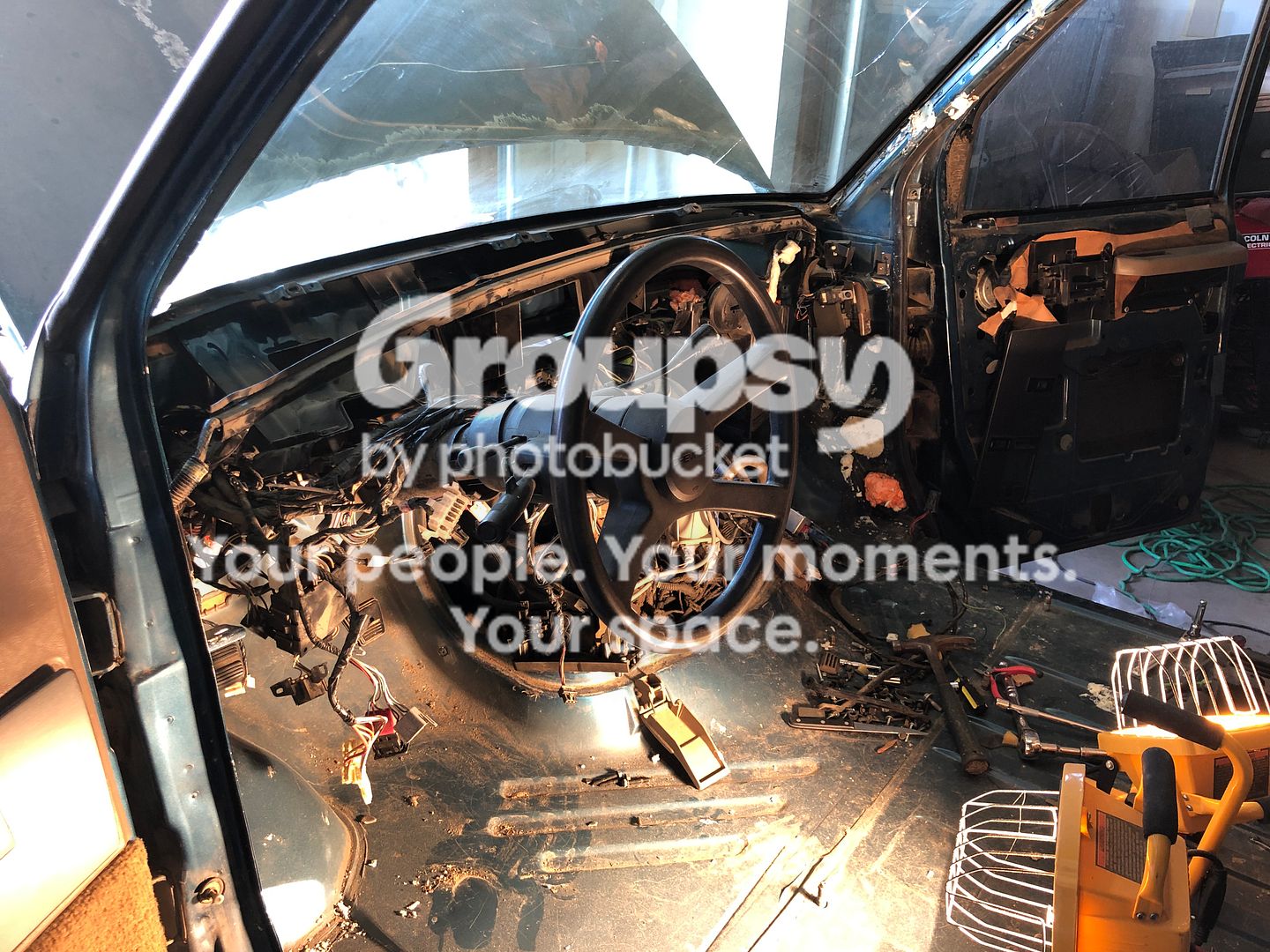

We decided to pull the dash out to get the fire wall sealed and vibraflex installed.
