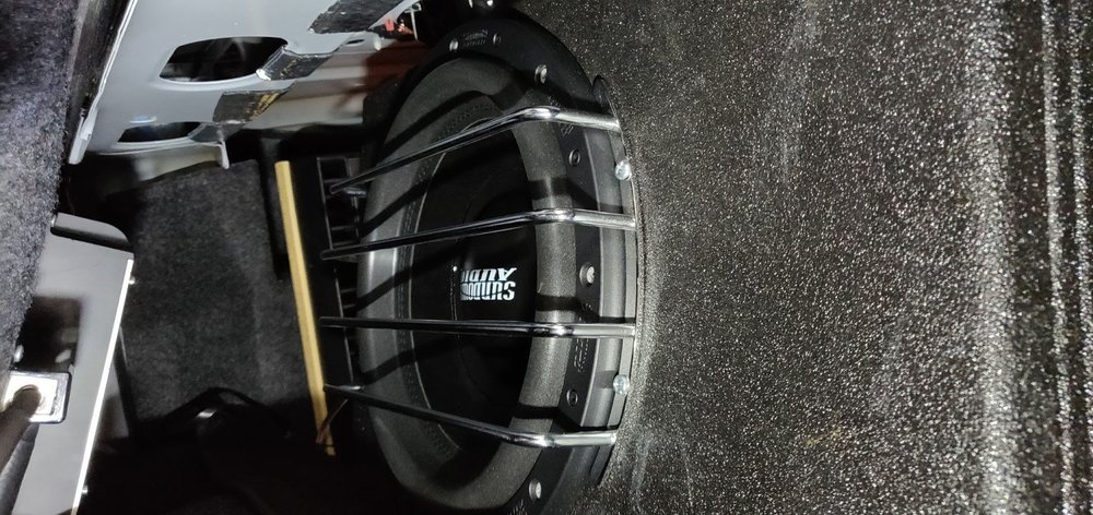

Greenfun13 Posted March 4, 2019 Author Report Posted March 4, 2019 Hey guys, I turned my box around and pointed the sub into the cabin of the car. Sounded about the same, MAYBE a little louder? However, I do like the added protection of the sub not being exposed to any cargo in the trunk. What is everyone's opinion on aeroports? My takeaway on them is that they are the most efficient port, but they do not add any strength to the box. Can you make an adjustable aeroport box? My current 1.8 cuft box is tuned to 43hz and plays everything from dubstep to rock with no problem. Just wondering how much the upper bass is going to be affected by lowering my tuning down to the recommended 32hz? Or should I meet in the middle and go 35-38hz? Could someone design me a 2 cu ft box with a max height and depth of 14". Width can be up to 32". Tuned around 32-34hz? Picture is of my box facing into the cabin and the amount of space I have between my backseat and sub face.
