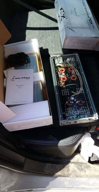

Cbphillips812 Posted March 19, 2019 Report Posted March 19, 2019 Alright guys got a 2014 chrysler 300 3.6l, right now I'm running 2 audiopipe 2 ohm bd4 15s on a wolfram 2400.1 stock elec. Factory alt is 180 amp, I have another wolfram 2400 I want to run both amps either strapped or gain matched my question is what size alternator do I need and how many batteries to run both amps and does my car have a voltage regulator in the computer, even if I upgrade the alternator is the computer going to cut down the h.o alternator to put out insufficient power, this is my first system that's going require power upgrade so I'm new to it

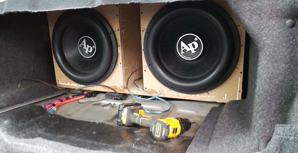

Joshdashef Posted March 19, 2019 Report Posted March 19, 2019 Those 15s are snug, but looks great man. For comparison I use a 240a mechman with two xs power batts about 105ah of agm. On a DC 2k and P3 12s but just switched those out and haven’t had the chance to start breaking them in. For the most part if I top my batts off every week or so I don’t dip below 13.8 on heavy songs, lighter songs I sit at 14 but due to Honda’s elecrtic load detector (pcm essentially) I idle at 12.8 or sit at 14.2 when it detects a load. For me I can run my fans without ac and it trips the load detector. Since your thinking of double my current power I would suggest either 1 keep the alt you have and get tons of batts / lithium / etc. 2 upgrade to a second alt or get a beefier single alt as high as you can go 300+ preferred. I wish I looked harder to find one that high because I can’t fit a second unless I made my own bracket from scratch. Also get atleast 150 ah of agm more is better. SMD Tool Map (2024): https://www.stevemeadedesigns.com/board/topic/226545-smd-tool-map-2024/ Great Box Bracing Examples: https://www.stevemeadedesigns.com/board/topic/202148-best-way-to-brace-a-box/?do=findComment&comment=3055002
Cbphillips812 Posted March 19, 2019 Author Report Posted March 19, 2019 Yea it took everything I had to get the box in there had to install the subs threw the back seat, I was looking at ebay alternator but read a bunch of bad about them so thinking I will save up for a mechman 370

Cbphillips812 Posted March 19, 2019 Author Report Posted March 19, 2019 Alright will do ? About my box I'm wondering if I sold split my port all the way out . My bass is kinda loose sounding my box is 38w x 18h x 20d my port is 4.5 back then 2.25 to each sub it's my first box build just doesn't hit like I feel they should
