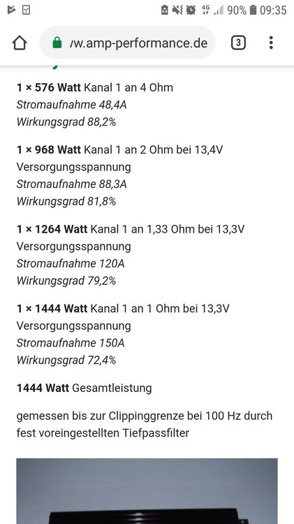

System on low power ?Am i running out of power ?
Its feels like i miss allot of power
If i put te amp up to 75% it sometimes gives a pop like is running out of power. Got a little bit of lamp dimming to. te current ampere it is pulling i dont know ( battery is full ) .will swapping to a optima yellow 80ah( 945 cold cranking ) solve mij problems ?
Currently running:
Dd815 dual 1 ohm on 2 on
Excursion hxa3k ( 20mm2 50mm3 is on its way)
60 ah bassic battery ( 515amp cold crank)
70 amp dynamo
Looks like your taxing the alt and draining batt, with that power you should be fine with about 75ah of agm and a big 3 but that agm should be dedicated. Or go bigger alt and big 3, and should be good if it’s only doing >1500 if you invest in the alt now you will have the foundation for a better system later when you decide it’s not enough and can just add batteries

The gain but it got no distortion a friend of me checked distortion at 88%
Bj3llo
Did the big 3 whit 20mm2 cables
Altanator i was thinking about as 80 ah alternator is the biggest for mij car stock ( maybe make a peugeot gti one fit 120 ah )
But that power i got now maybe causes some heavy dips that make a small pop ? As voltage drop and not a great backup
