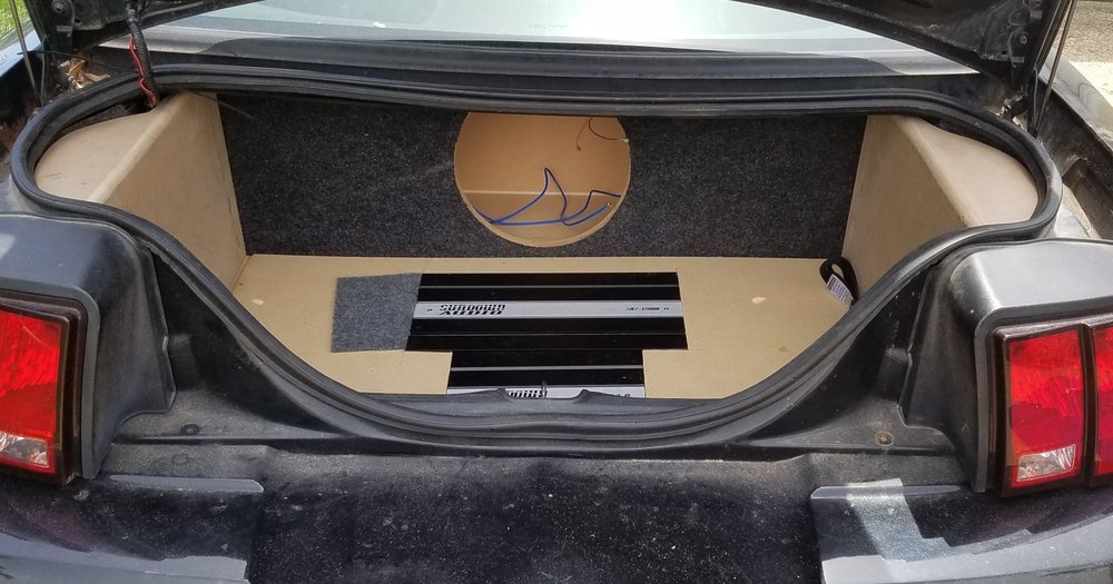

 I'm moving my amps from behind my seat to the trunk and I'm wondering if I shouldn't be adding a couple fans with the move.  This is my first time trying a false floor, so I really have no experience if just a couple cpu fans blowing across the heat sinks will be enough or if if 8 should be try to get some cooler air from the cabin? Right now I'm running a saz1500d at 2ohm to a sd3, but want to be able to drop down to 1ohm in the future without problems.

Check out Attwood or Seaflo fans...They're boat bilge pump fans but they work great...Move lots of air but they're noisy is their con
