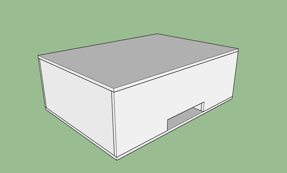

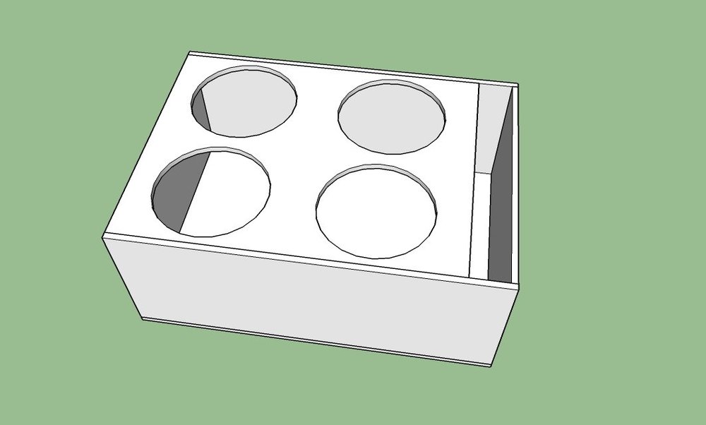

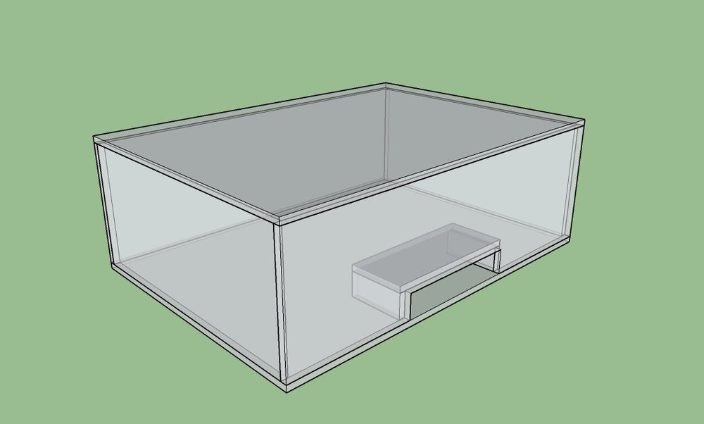

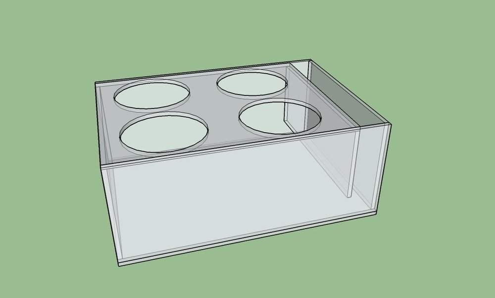

BassAddikt Posted August 15, 2019 Author Report Posted August 15, 2019 So, I sort of fixed the issue I was having with the rattling noise and turns out it was the screws mounting the subs had come loose...some were even broke in half 🙄 sooo, I put new screws in and it's all sounding alot better😁 HOWEVER, I'm still confused about how small the port is and how there's not alot of port area. Previous replies has mentioned it doesn't have near enough port area for 4 15s. I asked the installer about it and he basically said his software showed that 45 sq in was apparently enough for the build. I 3d modeled his box, as well as one that I designed, so you guys can get an idea of what my box currently looks like, and maybe let me know what you think? Much thanks! First one is my current box, subs facing up.
Triticum Agricolam Posted August 15, 2019 Report Posted August 15, 2019 4 hours ago, BassAddikt said: .... I asked the installer about it and he basically said his software showed that 45 sq in was apparently enough for the build..... I don't know what to tell you other than the guy who built your box is just plain wrong. 45 sq in is not even half as much as you should have. He messed up. The designs you came up with with the port on the side look good to me. Just make sure your port is long enough to get the tuning you want, just from the pics it looks kind of short. "Nothing prevents people from knowing the truth more than the belief they already know it.""Making bass is easy, making music is the hard part."Builds:
BassAddikt Posted August 15, 2019 Author Report Posted August 15, 2019 Thanks for the response. I wanna believe what my installer tells me cuz he’s a friend of mine but I’m well aware of how much you know about this stuff, as well as anyone else on here, and everyone on here talks about the “general rule of thumb” on port area which I know is just a basic starting point. But my point is that that goes against what my installer keeps telling me. And just to clarify- the first pic is the one my installer built (with the port in the middle. The length of that port is only 7.5”. The second design with the port on the top is the one I designed. The length of that one is about 14” tuned to about 34hz. My installer hasn’t seen my design but has already told me that he’d recommend not building a box “not knowing what I’m doing” because I could blow the subs. How likely would that be, exactly? I’d hate to blow them because I’m gonna eventually sell them to get some different ones in the near future lol
