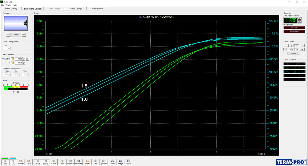

Here's the difference between the recommended 1.25 sealed box and going to either 1.0 or 1.5.   Going larger will gain a little output from 40hz area down but lose some above around 60hz.  Its the exact opposite going down to a 1.0 box, you lose some output below 40hz but gain some above 60hz.
Hopefully this helps!
Awsome! Thanks man that really helps out I mostly listen to rock and metal a little country music too.. I doubt that the extra output below 40hz would be worth the trunk space
