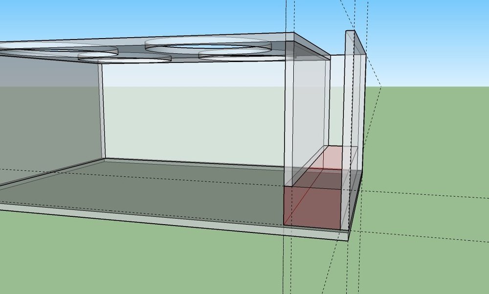

Hey guys sorry for not replying, been busy with work the last few days. So, the 3 cu ft per sub is only the net volume, and with 0.16 cu ft of sub displacement, that would mean the airspace for the subs alone would need to be 11.3 cu ft, correct? Alright, using my design for example (in the pic) would the volume of the red highlighted area be considered part of the airspace for the subs, or be considered as part of the port volume? I think thats the part thats kinda confusing me. The volume for the box part itself (excluding red area and port) comes out at like 12.1 cu ft. But since that is without the subs, I would subtract the displacement from that, giving me about 11.4 cu ft. Am I right? And what do I consider the red area to be apart of and do i add or subtract the volume of the red area to/from whatever part it is. I hope this makes sense lol I almost confused myself typing and explaining SMH
The red area is going to count as port volume.

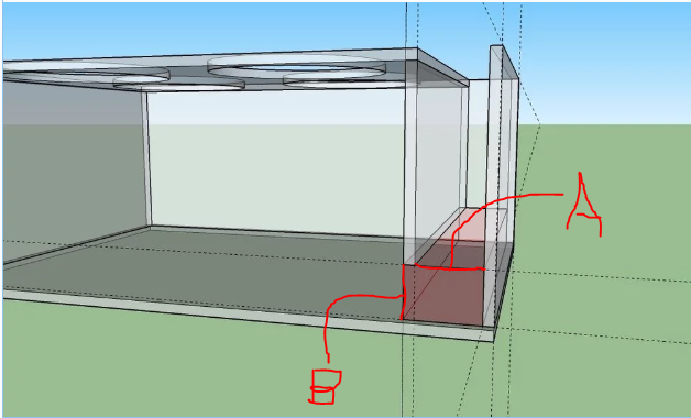

Quick question for you,  what is the length of measurement A and measurement B in your design?
Builds:
9 hours ago, BassAddikt said:
Does the bottom measurement (B) need to be the same as measurement A?
Yes, its needs to be the same, or greater.

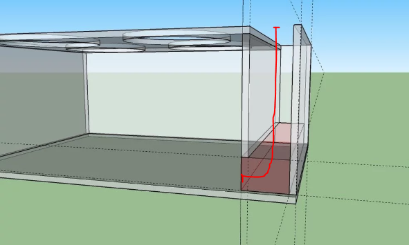

Also, the effective length of your port is going to include going around the corner at the bottom like this:
