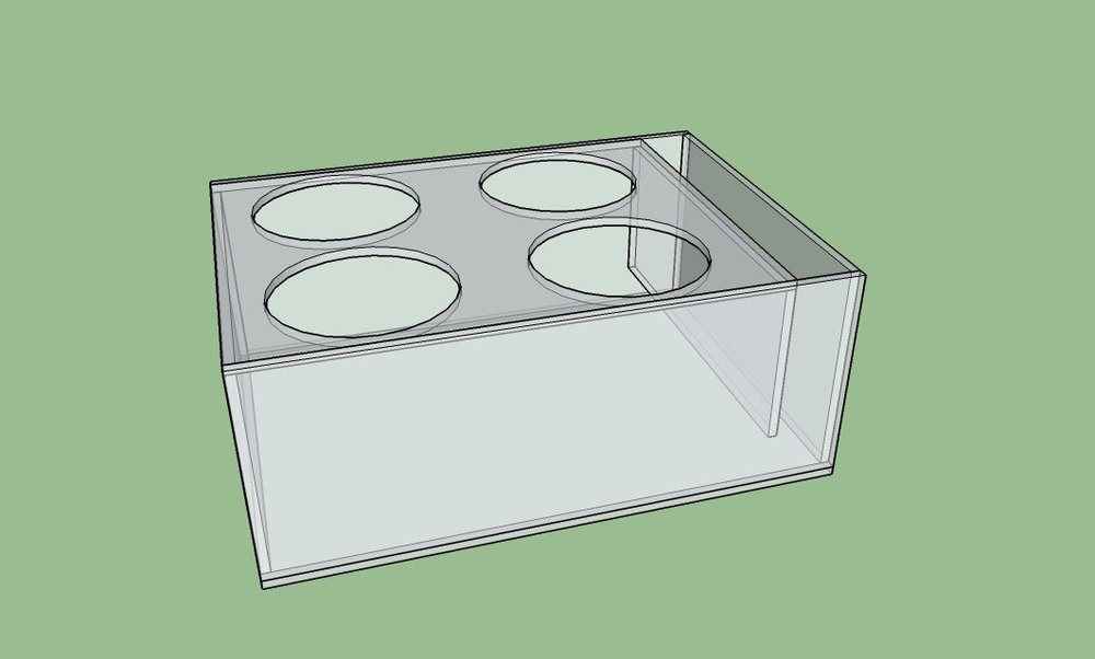

BassAddikt Posted August 15, 2019 Author Report Posted August 15, 2019 5 minutes ago, CstrokerV said: Wait your box he built and design. For 4 15s only has 45 sq inches of port? I had more then that for 4 12s Yes, that is correct. I modeled his box in sketchup so it would be easier to see. The port is 15"x3" and only 7.5" deep. He says its tuned to 29hz. After reading alot on this forum, I came to the conclusion that 45 sq in in nowhere near enough for 4 15s. The manufacturer specs say 35 sq in @ 14" long, and thats the specs for a single driver. So, I figured if you multiply that by 4, you get approx. 140 sq in or so. But here's the box he built, which is currently what is in my expedition. Don't get me wrong- it sounds pretty good and gets decently loud but I feel like they have so much more potential if they were in a properly designed box.

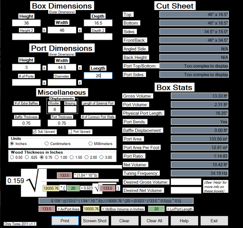

BYTizzle Posted August 15, 2019 Report Posted August 15, 2019 I saw your other thread and answered my own initial questions. MMats specs call for 3 cubes per sub net with 35sq in per sub. I wouldn't worry about the length spec since that will be what you "adjust" to get the tuning where you would like. If Im calculating it correctly, their tuning suggest around 34hz as the frequency (I really wish they would just call that out instead of the bass ackwards way they suggest an enclosure). You would need a bigger box to meet all of these specs! This would be close but you would need to measure to see where you could squeeze more volume in. This is 46x36x16.5, subs facing up, port facing the "hatch". Gets you the port area around what you need for 4 of those subs, the length to tune to ~34hz but its a bit tight on net volume.
BYTizzle Posted August 15, 2019 Report Posted August 15, 2019 Sorry this wouldn't post in the above post... If you reverse mount the subs you can pick up .6 cubes pretty quickly! Reverse mount and dropping the port length to 15" long puts you at 11.8 net at 34.2hz with 133.5 sq in of port area.

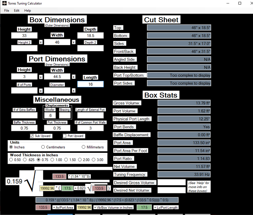

BYTizzle Posted August 15, 2019 Report Posted August 15, 2019 But going off those dimensions, magnets inside the box (regular mounted), subs up, port back, 11.5 net @ 34hz with 133.5sqin of port area using this setup: Edited because I put the port specs in backwards lol...
