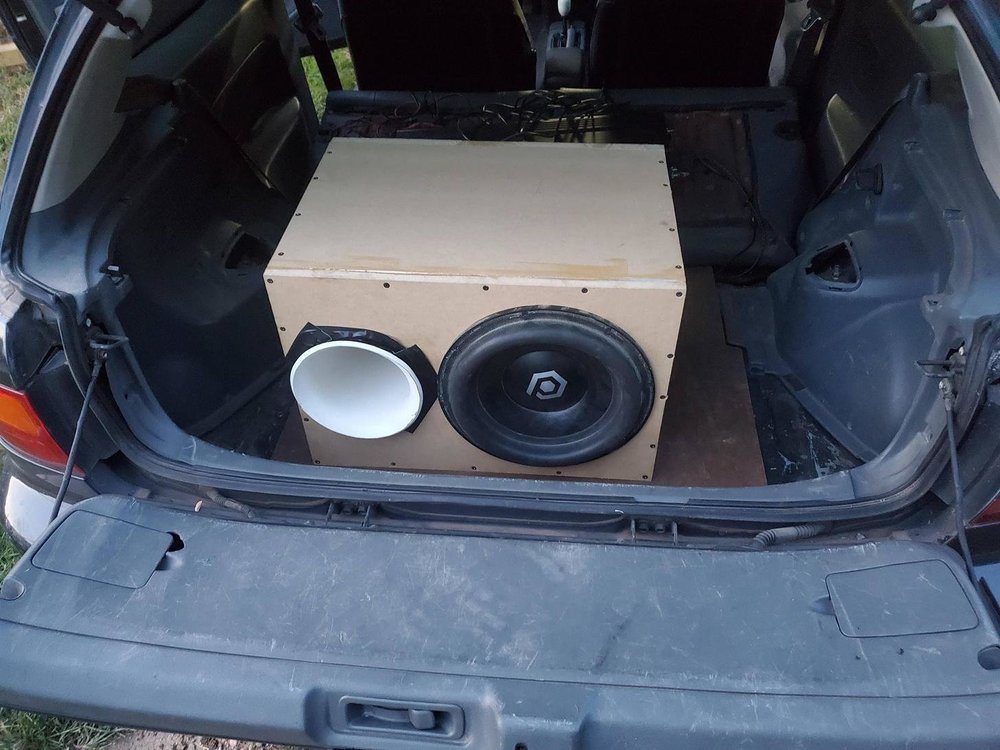

ok I will do some thinking on two or one sub I put it in my termpro and I can fit a 4 cube box with both of them and figured out 2 6 inch flared pipes would fit for 13in2 of port per cube and my original 4 cube box was only 7 in2 per cube. Im pretty sure that's why it didn't work but a good idea to only use 1 and a smaller box and be able to find better placement.  thanks everyone for the help ill post results soon
Well this is the back area with the new 2 cube box one sub a 6" flared port.  Did a 143.5  on 1002 watts just throwing it in there. It was getting late and didnt want to upset the neighbors to test more.  Shouldn't this thing be louder dropping in..
Pretty good for a single 12 on 1K clamped I'd think, it's a hatch correct? Maybe slide the box all the way back, facing up in the D/S corner?
You just have to play with positioning and tuning... good luck
In my experience limited cone and lower power usually means an efficient enclosure should be used tuned where it counts. I went fairly large with my Sa-15, tuned lower-mid 40's and was probably clamping less than 1K, I never metered it for real but it was fair to middlin' for SPL.
Tuned around 43hz in a medium SUV on a Chinese 3K @ 2 0hm nominal on completely stock electrical... lots of fail there but it did fairly good.
Pic...
it was 5.75ft3 net for a single 15 and still decently musical... well if you like rock-old school rap.
13 hours ago, Hondata said:
Here is the picture finally
I see you have lots of tape around the port.  Make sure everything is airtight.  Even the slightest leak at all will kill your output.
