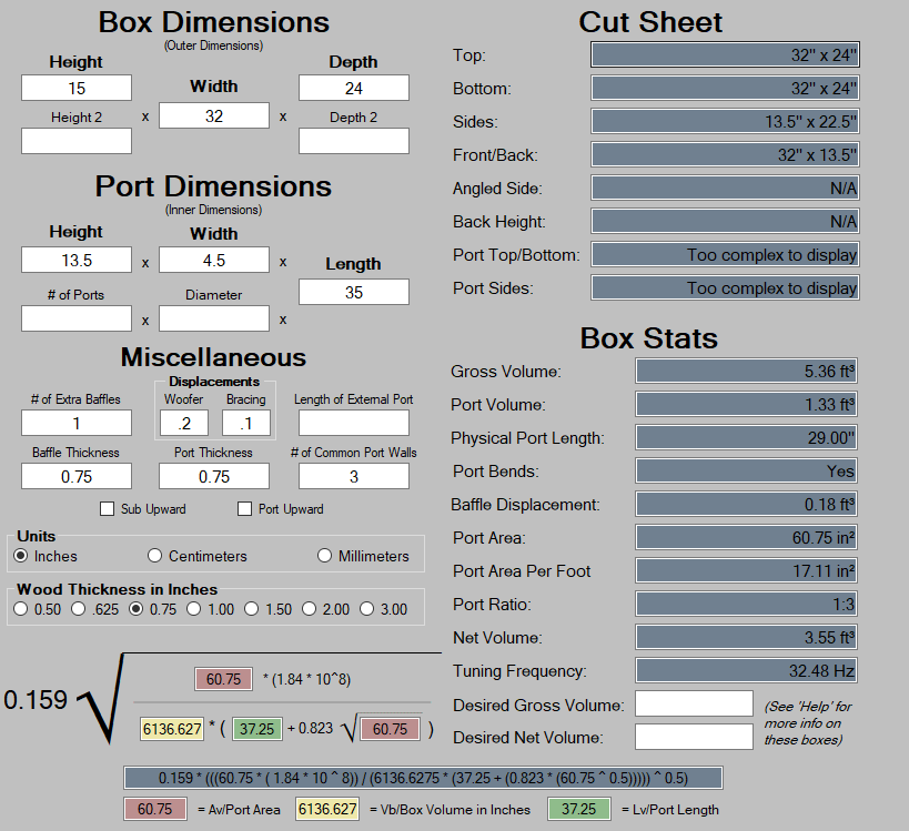

Another possible option is to go with something like this.
I would probably need to go back to the port in the center, but I would have almost 8" between the edges of the subs. Not quite all of that would be usable, but probably 7" of it would be. I might also be able to push them out a little more to the sides. the back is nearly 40" wide done like this. the box would take more time to build but would it work better?
Thanks for your help and patience! :)
right about now I am wishing I would have just went with a pair of 10" subwoofers. :(

A box like that would allow better use of the space you have available, but will be MUCH more challenging to build.  I guess it depends on if you are up for something like that or not.  If you do want to go that route I would get rid of all the 45 degree angles and square everything off.  The slight increase in internal volume isn't worth the increased complexity of making all those angled cuts.
If you want to stick with a rectangular box, here is the best compromise I could come up with using the space you have available.

I made another update to the more complicated version. Right now I have it back to 2 6" round ports at 28" in length. I could do that or the slot port. not sure which way yet I would go with that build. I took your advice and got rid of some of those angles.
Well I can get almost everything laid out on 1 48" x 96" sheet. there are a few small parts. I will have to pick up a half sheet also. Now if I could find someone local with a CNC that would really make this process go fast. :)

Ok I think this is what I am going with unless Someone says it needs to be tweaked. It is 33" wide at the bottom 36" wide everywhere else. it is now 16" tall instead of 15" and is still 24" deep. The ports are both 28" in length and 6" diameter. I will probably add a little more bracing inside and box will be Birch not MDF. Many thanks to Triticum Agricolam! You provided me with so much help!
Yup that’s looks like it should work great!
