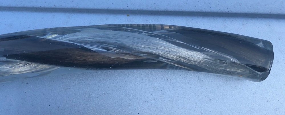

Got some speaker wire in the mail today. Also got one of those nice SMD round speaker terminals in. I was wanting green and black speaker wire but I couldn’t find any that wasn’t cca wire. So I went with this twisted wire. It looks pretty good. Just wish I could find some nice green and black stuff.

I have the blue/black sky high wire. Great stuff... no complaints at all and worth every penny. Never used the clear/smoked twisted stuff from KnuKonceptz. Kinda curious to see what you think of it.

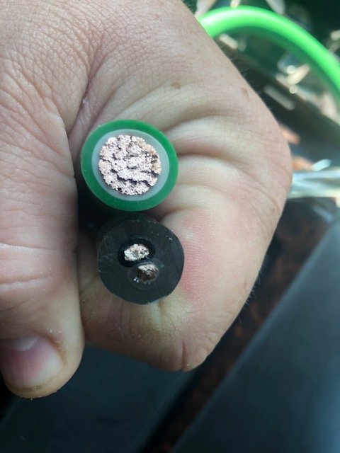

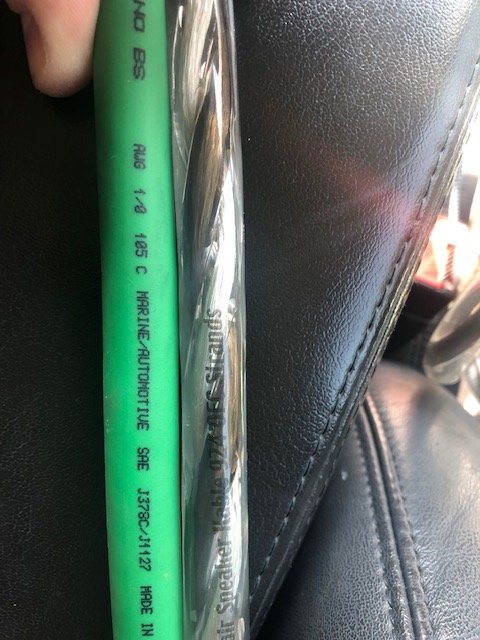

Ok cool thanks. I went ahead and ordered some of that green and black sky high wire. The KnuKonceptz stuff looks cool. I am am not sure it is actual 10ga wire though. it looks smaller more like 14ga then 10ga. it might just be the overall size of the clear making the copper look smaller. it is larger than my 1/0ga wire. I think it would look really nice in an enclosure with a window. It looks bigger than it is. I'll take some more pictures of it and post them.
Ok I guess it does look a little more like 10ga when I looked at it again. here is a couple of pix next to my 1/0ga wire. Please excuse my giant gorilla hands...

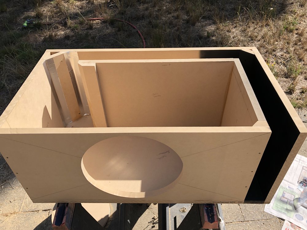

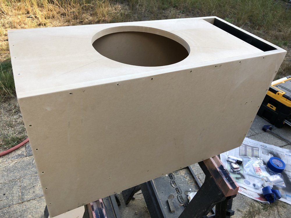

I just finished building my box. Only used a skill saw and it took about 2 hours to cut the pieces and another 6 to 8 to assemble them and install. Everything fit great (but I did have to shave one panel down 1/32”... otherwise no issues) and if you have a large enough table saw, that would make it even easier yet. Plus you get the satisfaction of saying you designed and built it fully yourself. Two friends came over to check it out yesterday and they were blown away! So ya... I wouldn’t pay a shop to cut the panels unless you’re all thumbs with a saw
