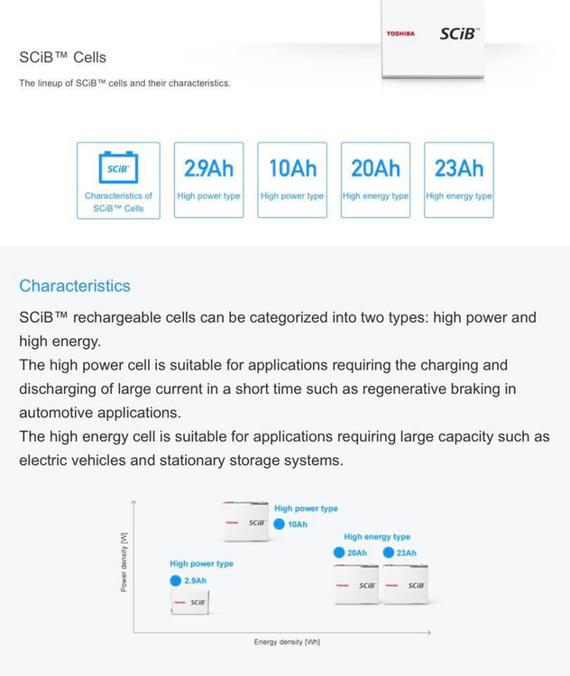

Below is some information we posted on our facebook page explaining the cells we use and a little bit of the guidelines and information on how the cells are connected within our cases.
Some have been wondering what cells are in the new Gorilla series batteries so we decided we would go ahead and officially publish what cells we are using. We’re using the Toshiba 10ah SCiB cells. This is a snip from the Toshiba website outlining the different cells they offer and the recommended uses for them. We used what we feel are the very best cells Toshiba has to offer. These are new cells that have never been cycled.
A few things to note about these batteries. Each cell is laser welded to nickel alloy strips. Laser welding is the most efficient way to transfer the massive amounts current these cells provide while keeping heat to a minimum. They are in a 6 cell configuration. Each cell is 2.4v so the nominal voltage of the Gorilla series batteries is 14.4v. That means they work best when your car is able to charge above the nominal voltage of the pack. If your car charges below this voltage our blue Lifepo4 battery is the best option for your application.
