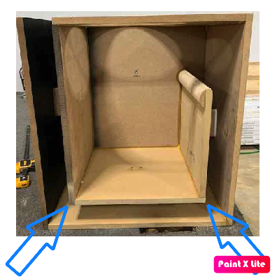

After that I installed the bottom of the box.
The first speaker baffle was next up.

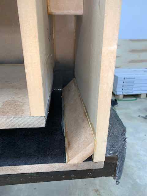

Up next was the 45s in the corners of port.

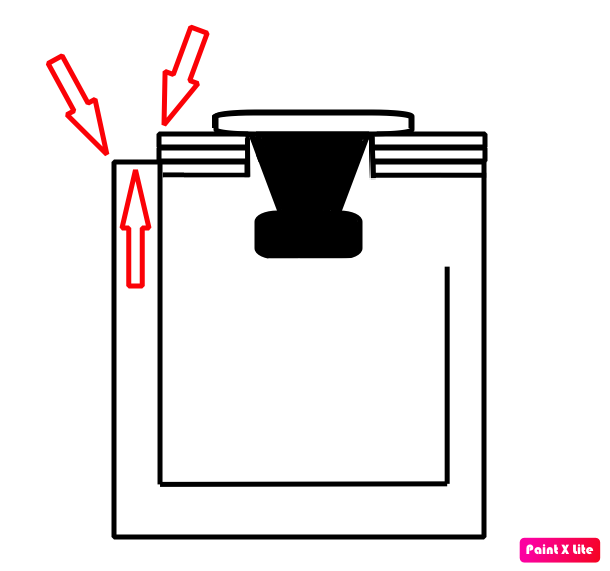

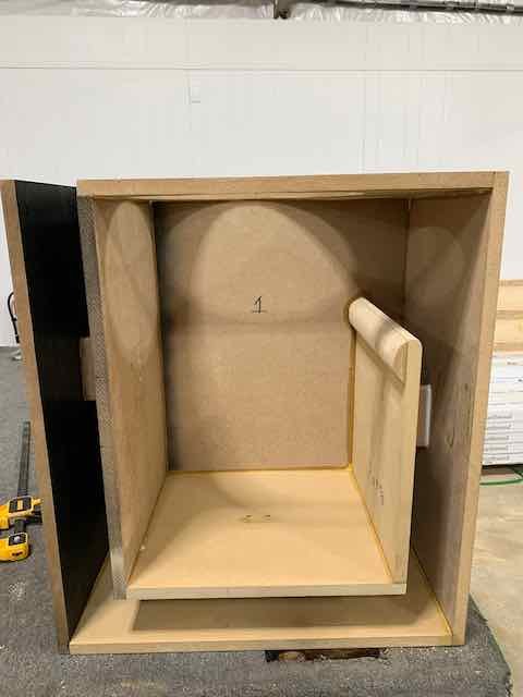

I do plan to round over the edges on the port opening. Also the second and third baffle layers will be a little wider than the first on. The first layer is in between  the two side walls. The second and third will sit on top of the sides.
Here is where I plan to round over the port ends.

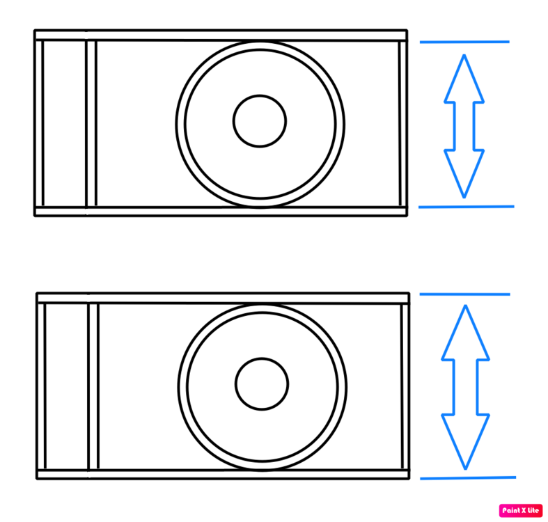

Here is the difference in the top baffles. The top image shows where the bottom baffle fits in between the sides. The bottom image shows where the second and third baffle will lay on top of the sides.
I hope that clarifies for you what I intend to do and answers your questions. Thanks for following my build.

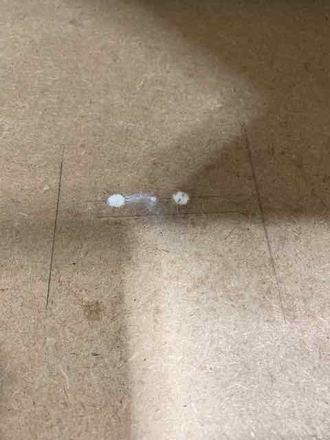

Hello everyone. Not much of an update today. I drilled the mounting holes in the top baffle and added the threaded inserts. I know what you are thinking "How were you able to fit all that into a single lunch hour?". Well it was tough and I had to work quickly. Seriously though I had to measure and remeasure because I laid out the mounting holes by hand. I didn't want to remove my sub just to mark out the mounting holes. Then remount it. Also I didn't take any photos. Seemed a bit too mundane to show off.

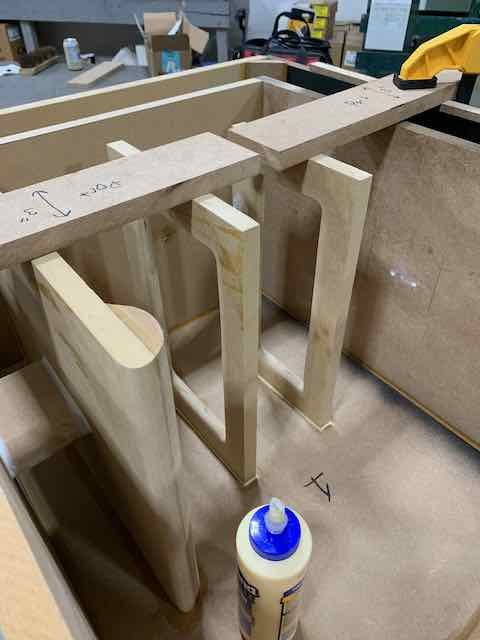

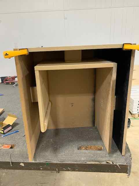

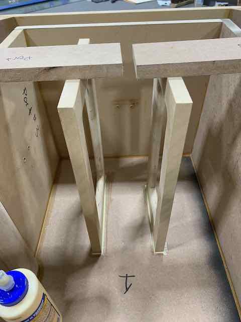

Just a small update today. I didn't have much time today to work on it. I was able to add the two main chamber braces.
After I added the braces I realized I should have rounded over the top and bottom of the braces.

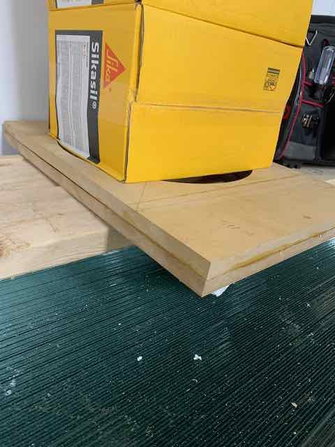

I also glued together the top two baffle pieces.

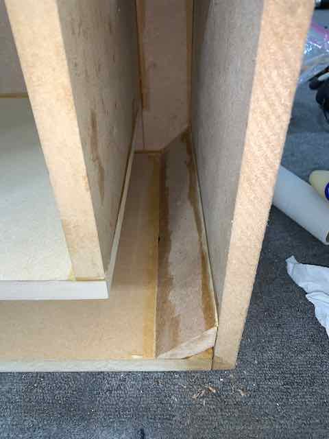

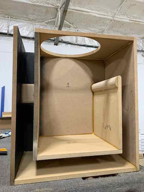

As I was looking at the new braces and thinking about how I should have rounded them over, I realized I should have also rounded over the inside corners of the port. Below is what I am talking about.
Oh well. Live and learn. I now have a lot of new ideas and plans for the next box I build. Next time I will be able to plan and build, hopefully, a much improved box.
"A nod is just as good as a wink to a blind horse." Rolf - Ed, Edd, and Eddy
I was wondering with all the effort rounding the port entrance why you didnt do the corners...
Sometimes you just forget lol. Your next box will be better hahaha
Looking good though
