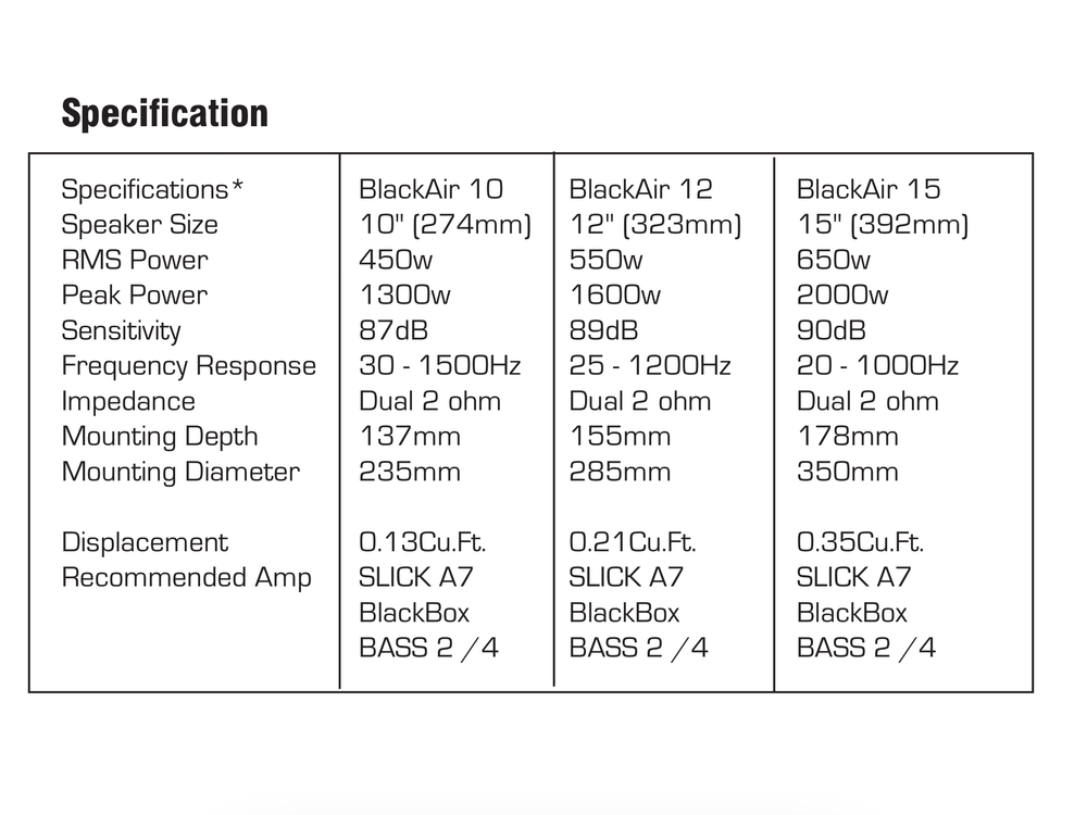

Singultus Posted December 23, 2019 Report Posted December 23, 2019 Hi guys new to the forum and 1st attempt at building a sub box so looking for any info or anything that may be useful I am unsure of how exactly to wire these up being dual voice cone and having 2 of them and not knowing a lot about dual voice cone subs do I wire them as shown in pic here https://imgur.com/a/iM7aZOW I have 2 12” vibe blackair subs Specifications in pic 1 1 vibe blackbox bass 1 amp specs in pic 2 and I’m looking at building the box shown in the rest of the pics on imgur link below https://imgur.com/a/6xiGEew
YukonXL04 Posted December 23, 2019 Report Posted December 23, 2019 Yup, wire them just as you have in your picture for a 2 ohm load. Are you certain you have dual 2 ohm subs? 18 Sierra 6.2 Z71 : 3 F8L's, DD M2a @.67, 1.95@33 05 TL build log SOLD 04 YukonXL : jvc kw-v51bt , RE 6.5c, 4 jbl gt5 12s, Memphis pr1000.1 5.5 cu.ft. sealed
Singultus Posted December 23, 2019 Author Report Posted December 23, 2019 2 minutes ago, YukonXL04 said: Yup, wire them just as you have in your picture for a 2 ohm load. Are you certain you have dual 2 ohm subs? If I’m being perfectly honest I don’t know a hell of a lot about them as they were bought 2nd hand but everything I do know is what I’ve read in the manuals online and on the subs themselves as shown here https://imgur.com/a/YXlwdYF
YukonXL04 Posted December 23, 2019 Report Posted December 23, 2019 2 hours ago, Singultus said: If I’m being perfectly honest I don’t know a hell of a lot about them as they were bought 2nd hand but everything I do know is what I’ve read in the manuals online and on the subs themselves as shown here https://imgur.com/a/YXlwdYF Good deal, yes just wire them like the diagram you linked first and you'll be good to go 18 Sierra 6.2 Z71 : 3 F8L's, DD M2a @.67, 1.95@33 05 TL build log SOLD 04 YukonXL : jvc kw-v51bt , RE 6.5c, 4 jbl gt5 12s, Memphis pr1000.1 5.5 cu.ft. sealed

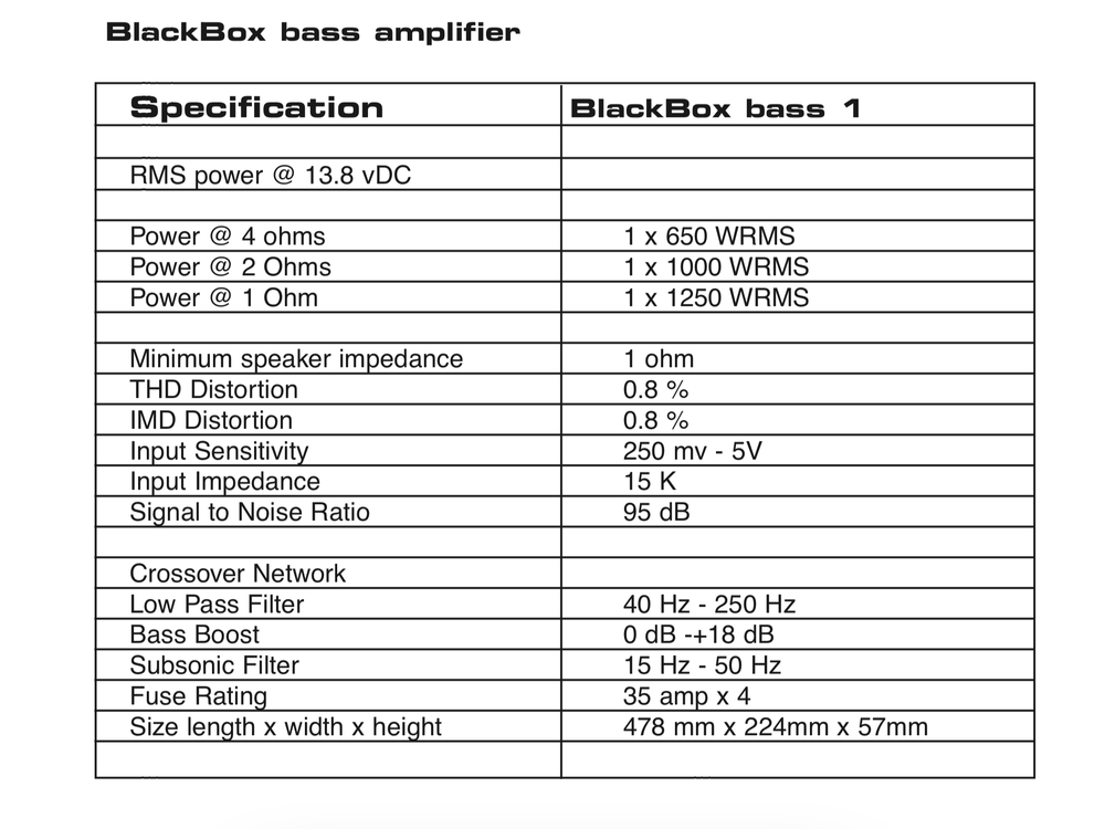

Singultus Posted December 24, 2019 Author Report Posted December 24, 2019 Ok so after a little more digging/researching I’ve realised that the amplifier has 2 outputs and rms @ 1 ohm is 1250 watts and a peak of 2500 im assuming that would be shared between both outputs so would I be better off wiring each 1 in parallel to get 1 ohm each and then wiring to seperate outputs? Would this actually give me a 1 ohm impedance for each sub or am I misunderstanding how it all works, or would it be better to wire each in series for 2 ohms since the amp rms @ 2 ohms is 1000watts and the sub rms is 550 watts and wire to seperate outputs not gonna lie I’m getting more and more confused the more I read lmfao
