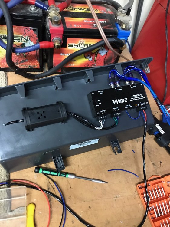

Here's where I'm at.
Oxygen tweeters
Excelon 1800 coaxils
gm-d8604 pioneer 500 RMS 4 ch
Stock 3.5 mids in dash
Factory stereo
wirez lcssl10-4 output converter.
Wired stereo to resistors to loc to amp back to stereo so I'm told,wired in parallel , everything wired to 4ch amp.
Just picked up my truck from the installer..this system sounds quieter then my last... I'm not that happy atm, adjusting the gains he made sound confusing, also has bass all the way off on the factory stereo.
Suggestions??

Resistors in black box 47 ohm 5 watt

Well that's the way he decided to do it I guess...am I fukd? Lol
Just a quick look and i found this. These are about $250 but integrates everything to work next to flawlessly.  I don't know what that resistor set up would be for when the LOCS have been out for a decade to integrate after market system into new vehicles.
I don't know what all he did to your truck but factory harness should never be cut these days.  I would look into a LOC and learn how to install it or have another shop look at it.
The wirez is the loc?
Not a Pac Loc for your truck.  See all the wiring that comes with it?  The Pac Loc in the picture keeps all factory wiring stock & uncut, keeps all the stock wiring live and then gives you pre-outs for rca's.  I am just saying this is what 75% of car audio integration systems have.
I am just trying to give you some info.  I am no professional but i know whats working out there.  Your not happy with it so maybe his way doesn't work. ?
