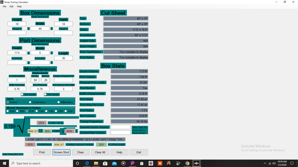

that's with double baffle, 45 degree corners and a single brace from top to bottom and face to port wall for displacement

at top of torress page is "box deimensions" that's the outer size of the box, I could work up a cut sheet for you if you want too. I also tried it with an aero port and a 10' would give enuff port area but you would have to add quite a bit of bracing to make sure it didn't blow apart.

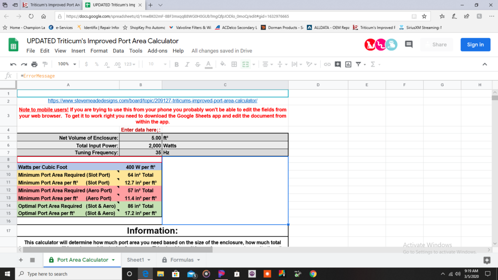

And honestly the box gunnem linked is designed for a pair of xfls , port area "may" be kinda small compared to triticums calculator but it's got to be pretty close and will like he said perform very well also. That's if ur not prepared or capable of building a perfect box of your own. It's alot more work than just building a square with a hole lol.

Wasn't an intended to be ride or talking down just saying lol. But the numbers and stuff I put up will work and work well. I can swap out to an aeroport for ya if you want but length of port probably would require a bend or placement on a side which would mean tweaking width to compensate for clearance. Hell I wish I could find a prefab that'd work for my setup, I'm dreading building a box Sunday lol..have 3 to build to make it worse. I am very capable but damn it's a mess and a pain in the ass sometimes!

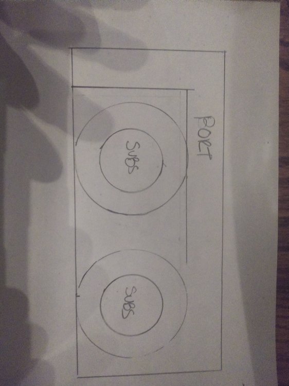

Yes u can so subs up port back , gimme a few to change something's and I'll repost a Torres page. With suvs and subs up vs back most get ALOT more rattle and roof slapping tho

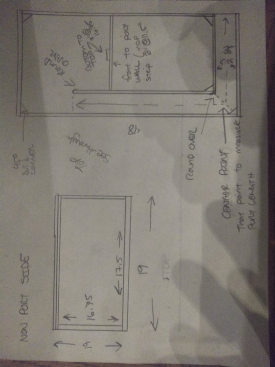

that's subs up, port back. be aware that the subs wont be able to be centered in the box because the back edge of the box has the slot port in it so subs will have to be closer to the back edge of the top of the box.

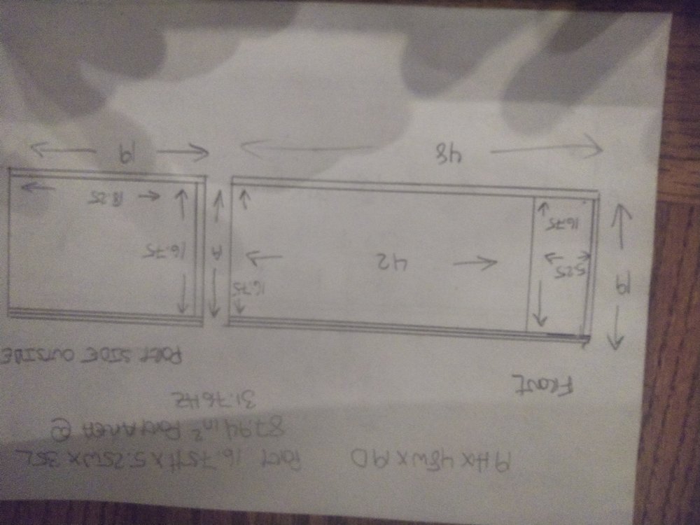

Have to put the subs  where they clear the port wall, closer to the back edge . I am NOT an artist, more autistic I think lol. My drawings aren't proportional but I THINK measurements are there tho. Had to change Torres , will post it next when I'm on my laptop. What I have noticed about Torres if u keep changing numbers it get funky, gotta close and restart it and the same dimensions and volume will change.
I spent last hour with sum Tito's and orange juice, a few sheets if paper , ruler and a pencil lol I hope it all makes sense and helps ya out! If u build it, you owe me a good video if those xfls beating ur suv up for my time!
