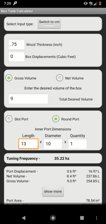

What subs are u using? Based off ur max. This a big box 9cu an some change. Here's port info

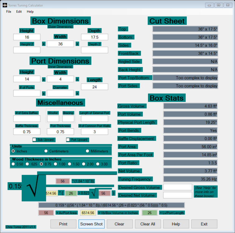

so this is with a slot port, you'll have to put a corner in the port and continue it along the back of the box.  not difficult at all.  also this doesn't include bracing or sub displacement.
but this is as good as i could do in a few minutes.
2.3cu ft per sub, fits in your space, tuned to the right frequency.

they call for 2-2.5  the design i gave you lands directly in that

When I had my xfl I went through a few boxes and it seemed to like closer to 3 cubes but sounded great in every one I had from 2 cubes up. Just make sure you got enuff port area, those things move sum serious air! I'd use triticums port calculator for sure.
