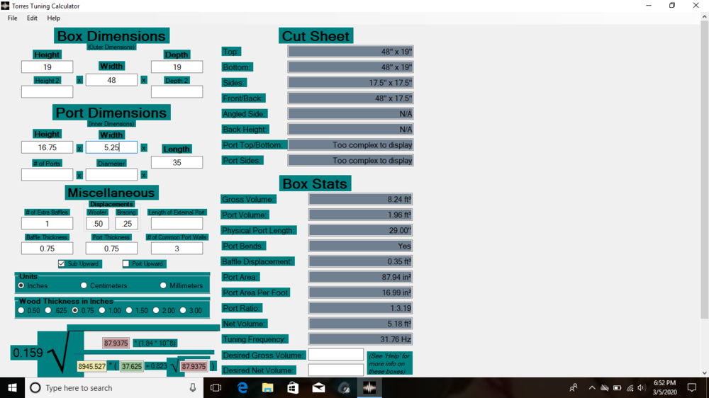

here is last torres page, goes with box pics I posted previously. 474141014_Screenshot(41).thumb.png.139330be3725b6e01bb9b913c15e6968.png

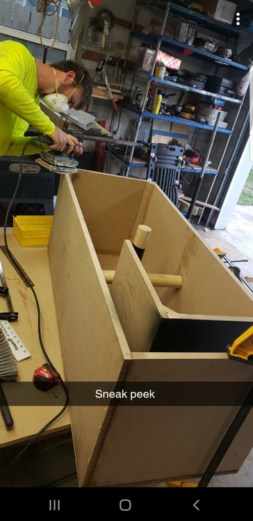

Thanks man I really appreciate it I'm gunna be working on it this weekend hopefully I can have it done. I'll definitely have a video for you when I'm done. Gotta a cool set up for my amp. I'm pretty proud of lol. I'm hoping by next weekend I'll have it in!
I had to sand about a 1/8 -  1/16  off that corner but other than that it was just about perfect cuts. I used a (2) 2inch in a dowels with a 2inch whole saw to notch it out so it slid in for a brace. 45 all the corners rounded the ports. Glue and clamp plus caulking all the seams inside even tho the glue pretty sealed it. I haven't got any videos yet but I will try to post one here soon Maybe tonight
