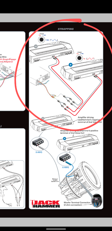

I'm in need of more power so I'd like to strap two identical amps which don't strap (in the normal way).
Amps: 2 - Arc audio 2300SE
Interconnects from the processor into each amp. Except one of the amps will be fed the same exact signal, but 180° out of phase.
Use the positive terminals only on each amp
Wire the in phase amp to the positive post on sub.
Wire the out of phase amp to the negative post on sub.
Gain match both.

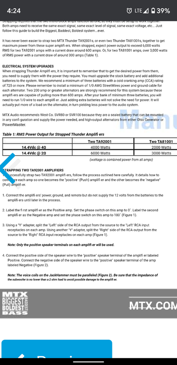

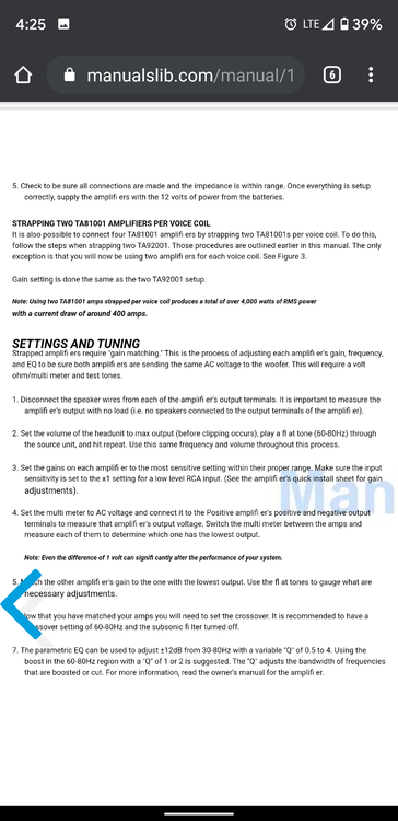

Mtx did this on their thunder elite amps, but they had a dedicated phase switch. Check out their instructions...

54 minutes ago, AaronT said:
Watch this video explains the pitfalls of strapping amplifiers even ones that can be strapped you still going to have phase issues that need to be ironed out even when strapping strappable amps
What do you really gain from it I mean it ain't like you're gaining anything really your lowest impedance doubles
Better off just game matching the amplifiers
This is perfect 👍👍 exactly what I'm trying to do. thank you
