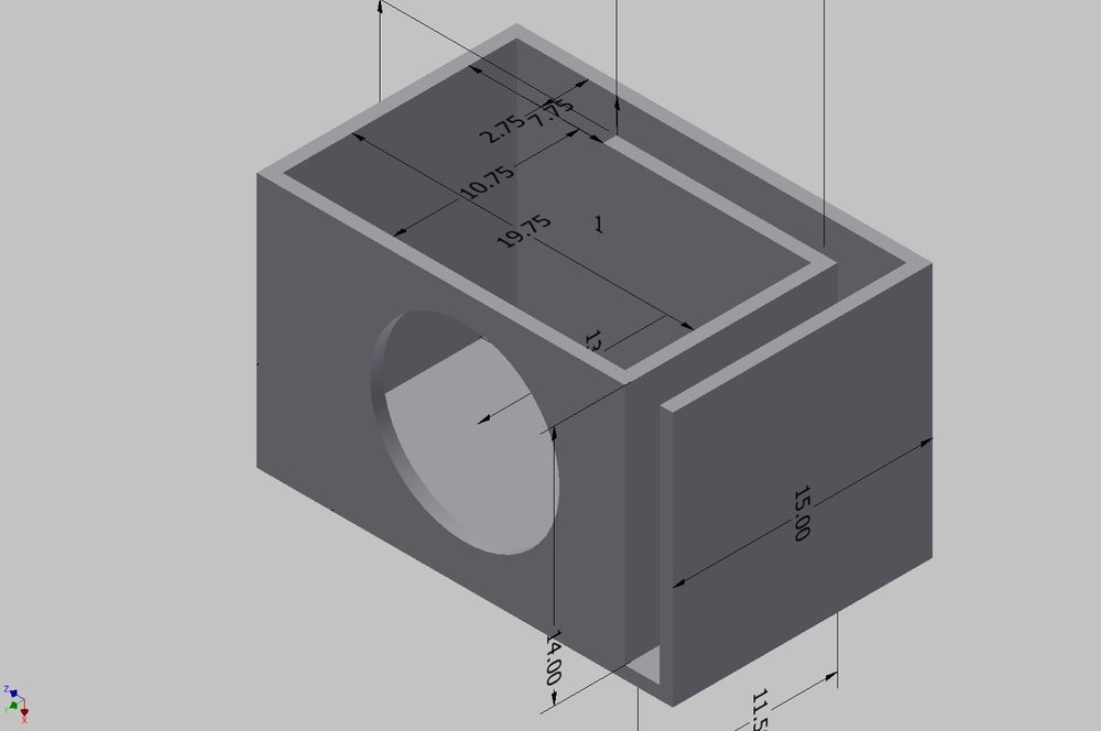

Doors and rear deck have some RF Prime 6.5's and just recently swapped the head-unit to a Pioneer 2550NEX which really woke the RF's up but its still lacking in the bass department. My thought since its a daily and trunk space is still sorta important, I was planning on building a 1.75 cu.ft ported box to have some low end without rattling the car apart but we all know things snowball into bigger projects
Any suggestions or recommendations are welcome
Here's what I have for a box (3/4 MDF, SMD terminal cup on the left side, according to winISD and some math, it should be tuned to ~38 hz. It will have bracing in the corners but I got lazy and didn't feel like taking the time to put them in the drawing.

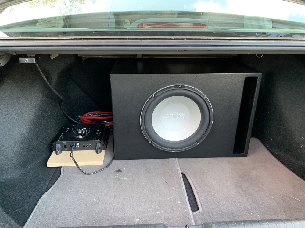

It ain’t much but I think it’s decent for the first time building a box
First time building? Looks pretty damn good man! I think it looks awesome, especially those terminals.

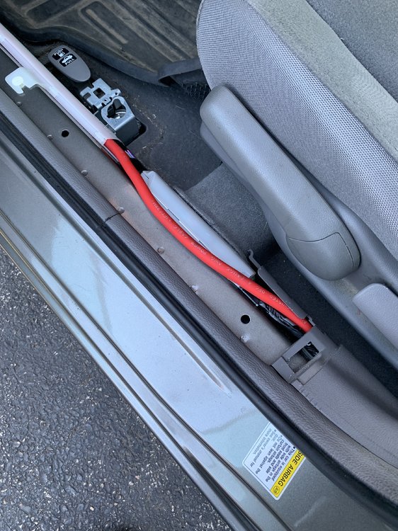

Excuse the mess but running power wire in small cars isn’t fun.
No it is not, especially these civics. I had to pull all my interior out to run my two runs of 1/0
My advice is to get you a good set of panel tools.

Yeah it wasn’t fun trying to get it ran with wiring on the drivers side. Ended up fitting it inside the white wire covers with some persuasion. For 1 12 ran off an old mtx 421d it’s pretty loud. Forgot to run the remote for the amp volume so I’ll need to pull it apart again for that. Also need to figure out where to set the crossover on the amp. Got the gain roughly set via the old multimeter trick but I’ve just been guessing with the crossover.
Need to figure out a better amp mounting solution but temporarily have it screwed to a left over piece of mdf. Thinking I could mount it behind the trunk liner on the left hand side
