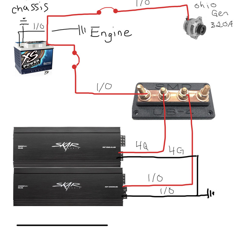

Hello everybody, i made a sketch of my set up and was just wondering if everything looked correct?
i have an ohio generator 320amp alt with the big 3 done, positive of alt to positive to battery, negative of battery to chassis, and negative battery to engine block
from the battery i have 0 gauge ran to a distribution block which splits into my two amps and then the two amps are grounded to the car body
Looks fine to me. Only thing i see is if your car has a frame ground to that instead of the body.
Also if your amps dont have fusing built in id run a fuse between them and the distro block.
Thank you, and it is grounded to the bolt that holds the back seats in...and the amps do thankfully have a built in fuse
I would also fuse the wire from front to back at start and end.
I've personally had issues grounding  there, and so have other people because they told me about it when I researched my problem.
You'll get noise through your speakers.
I don’t get any noise through my speakers
